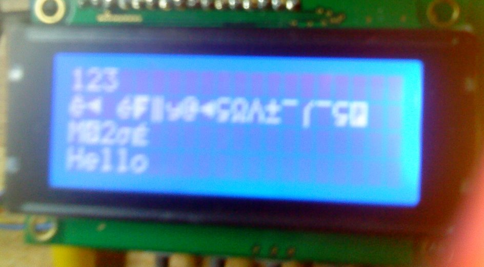

Hello
I have a odd problem when using a standard 4x20 LCD display connected to a 18f46k80.
Writing numbers (bytes) to the display works.
Writing Strings to the display gives the wrong cgaracters on the display
Writing ASCII characters codes gives the right characters.
The attached flowcode file works in simulation but on real hardware it looks as in the blurry picture.
The same flocode file compiled to a 18f4550 using the same display woks as it should.

Please ensure you have the configuration setting "Extended CPU" or "Extended Instruction Set" disabled or strings and other arrays will not work correctly.

Disabeling extended setting worked.
Thanks!
