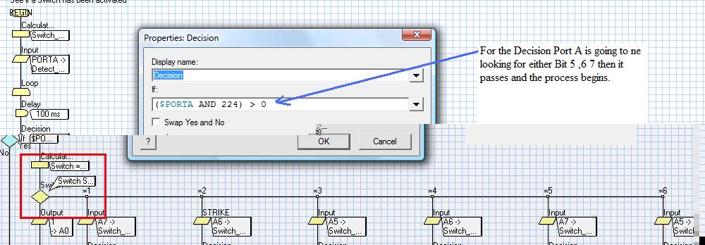

I thought I had a grip but tonight I’m stumped.
I set a Decision statement to see if PORTA > 2 so it can jump into a routine to check which switch has been activated.
I activate ( Ball ) or Port A Bit 7.
So the Decision does activate because PORT A is value 7.
The display for Ball advances then I stop the switch so now PORTA = 0
The Decision FAILS and just keep looping thru all my scan keys.
Here is a picture
Here I have 1 = Ball displayed
The Variable table list PORTA as value 0 but for some reason when I get back to the Loop and into Decision does PortA > 2 it buzzes right past ??
Here is a picture

Hello John,
The $PORTA reads the entire port including the pins you are using to drive the 7-seg displays.
I would instead use an input icon with masking to copy the input pins into a variable and then use that variable in your decision icon.

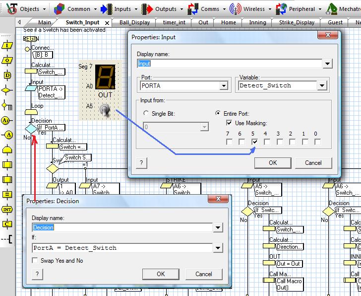

Hi Benj
Well I think I tried but I tried everything I could think of for the Decision step but I could not get the flow to come in to detect the switch.
I simplified it to be just 1 switch A5 Port A.
I believe I followed your steps. But I must be missing something.
I spend just about equal time doing images as to working the project.
John
John

If you want to check one bit (bit 7) your if should be:
($PORTA AND 128) > 0
The other bits are:
($PORTA AND 1) > 0 - bit 0
($PORTA AND 2) > 0 - bit 1
($PORTA AND 4) > 0 - bit 2
($PORTA AND 8 ) > 0 - bit 3
($PORTA AND 16) > 0 - bit 4
($PORTA AND 32) > 0 - bit 5
($PORTA AND 64) > 0 - bit 6
The 'AND' values are the mask. If you wanted to check multiple values on at the same time, say bit 0 & bit 7, the if would be
($PORTA AND 129) = 129
The other bits are:

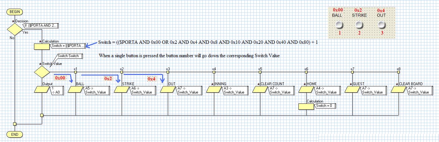

Hello Leigh
Thank you for the further information. My plan is to see if it is possible to take the single Push buttons and use the value to route directly down the Switch Value.
Here is a sample flow I put together to show the flow.
I tried to different formulas but it is not my forte. I had trouble coming up with a formula.
There will be 8 incoming push buttons. They will be PORT B ( 0 - 7 ).
The vision is have PORT B - 0-7 as Port B set to (INCOMING) then the code will switch to Port B to (OUTPUT) and send the bit pattern out to control chips.

Hi John,
Attached is how I detect which switch has been pressed.
It's the easiest way I can think of.
- Direction Flow 414 V2.fcf
- (73.92 KiB) Downloaded 309 times
