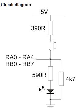

The connections for the LED: ( from the help menu )
Combined LED and switch circuit
We find this general LED and switch circuit allows you to use either a switch or a LED on a I/O pin of the Chip. The LED's in this component are wired with all cathodes connected to ground and the anodes of each LED are connected to a suitable Chip port via a 560 ohm resistor.
The 4k7 resistor is used to pull the pin down to a logic level of 0V when the pin is used as an input and the 390 ohm resistor is used to limit current flow when the switch is closed. John
I have been doing some investigation and this is what I have found.
From the info if I can set the Input switches to Input flowcode should be activating the 47K resistor to stop the LED form coming on. This is not happening when I press the Button the LED lights, I suspect I'm missing the code to set the switch to ( INPUT ) and activate the 47K resistor. I will have to keep the buttons as Active High. I will rework my PCB to Active high.
If someone can help me set input as (INPUT) to activate the 47K should wrap up my project.

The reason why I asked about the resistors is that the way you describes the led and button schematic in you pdf creates quite simple voltage divider at the PIC port. So if you use the 10kohm resistors the voltage goes like this (5V - 1.8V)*(30kohm/10Kohm) + 1.8V...
That 1.8V is the forward voltage of the led.. So the voltage at the PIC i/o pin is something like 2,9V when the pin is an input and switch is open, and thet might not be enough to read pin correctly (usually the min Vin_hi voltage is something like 0,7*vcc = 3,5V)..
Sorry my bit bad English, but are looking at solution that when you use the port as input, the led should not work, and when you use it at output, the led should work?
Mika
Mika

The led is quite hard to get work that way that it don't react when the switch is pressed, at least I don't know how that could be done..
Isn't is possible to move leds different port than switch?
Mika
Mika

The only way that I can think to get the button and Led working as you want is use 3 volt zener diode serial to diode, like picture below .
The led and 3 volt zener serial should let the pullup resistor rise the voltage at 3v+ LED forward voltage (about 4.8V), but the pullup resistor is so large that led don't light up.. The button (ST1) is active low, so the voltage at PIC i/o pin is 0V when the button is pressed.. And when the PIC port is output hi, the led should light up... The R_SER is to protect the PIC i/o port, and limiting the LED current...
Mika
Mika

From you picture it is possible to drop the voltage with a Zener Diode but in the documents Flowcode is using the 47K to shunt the LED with the option of setting the Port B as INPUT.
The mystery is how to inform Flowcode to set the Port B as INPUT and when needed switch to OUTPUT.
John
John

No it's not possible...JLeith wrote:Evening Mika,
John
Using the port both at the input and output is quite easy, if you mean the way that is the last picture what you had posted (by the way the resistor 4k7 = 4,7k, not 47k) , the port works ok both input and output, BUT the LED will light up when the button is pressed, so that is the "hard" part, to get LED the not react the button...
If you don't have 3V zener, you might test 4-5 (depends the forward voltage) normal diode at series, but the resistor don't work...
Mika
