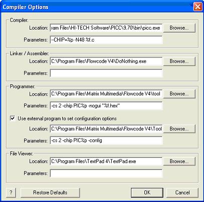

Once you have installed the compiler you need to point Flowcode to the HITECH installation directory to allow the compiler to be referenced by Flowcode. To do this open Flowcode and then click on the "chip" menu and select "compiler options".
In here you will need to replace the information in the top four text boxes with the following information ensuring that the paths are correct for your installation of HITECH.
If your using a 10F, 12F or 16F target
Compiler Location 32-bit OS = C:\Program Files\HI-TECH Software\PICC\9.83\bin\picc.exe
Compiler Location 64-bit OS = C:\Program Files (x86)\HI-TECH Software\PICC\9.83\bin\picc.exe
Params = --CHIP=%p -N48 %f.c
If your using a 18F target
Compiler Location 32-bit OS = C:\Program Files\HI-TECH Software\PICC-18\9.80\bin\picc.exe
Compiler Location 64-bit OS = C:\Program Files (x86)\HI-TECH Software\PICC-18\9.80\bin\picc.exe
If your using a Matrix target with Matrix USB bootloader eg MIAC, ECIO
Params = --CHIP=%p -N48 %f.c --CODEOFFSET=800h --ROM=default,-0-7FF --OUTPUT=inhx032

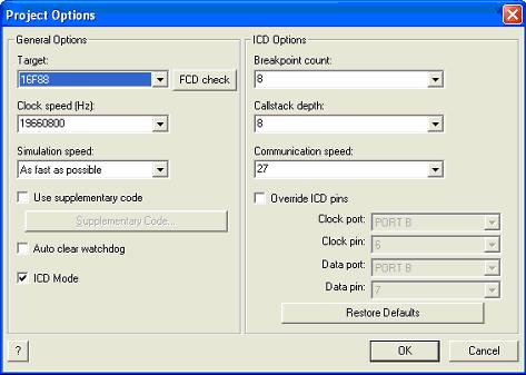

If you are using the ICD functionality with the HITECH compiler then you must ensure that the communications speed in the project options is set to approx 3x what it would be for the default BoostC speed. For example at a clock speed of 19660800Hz the default ICD rate is 9. Multiplying 9 by 3 gives a rate of 27, which should allow the ICD to work when compiled with HITECH.

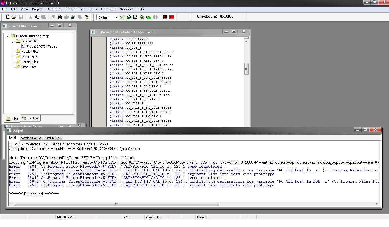

I am trying use FC5 with HiTech 9.8, but in MPLAB 8.63 and it not works.
Build C:\ProyectosPic\HiTech18fProba for device 18F2550
Using driver C:\Program Files\HI-TECH Software\PICC-18\9.80\bin\picc18.exe
Make: The target "C:\ProyectosPic\Proba18FCV5HiTech.p1" is out of date.
Executing: "C:\Program Files\HI-TECH Software\PICC-18\9.80\bin\picc18.exe" --pass1 C:\ProyectosPic\Proba18FCV5HiTech.c -q --chip=18F2550 -P --runtime=default --opt=default,+asm,-debug,-speed,+space,9 --warn=0 -D__DEBUG=1 --addrqual=ignore -g --asmlist "--errformat=Error [%n] %f; %l.%c %s" "--msgformat=Advisory[%n] %s" "--warnformat=Warning [%n] %f; %l.%c %s"
Error [984] C:\Program Files\Flowcode\v5\FCD\..\CAL\PIC\PIC_CAL_IO.c; 120.1 type redeclared
Error [1098] C:\Program Files\Flowcode\v5\FCD\..\CAL\PIC\PIC_CAL_IO.c; 120.1 conflicting declarations for variable "FC_CAL_Port_In__x" (C:\Program Files\Flowcode\v5\FCD\..\CAL\PIC\PIC_CAL_IO.h:42)
Error [253] C:\Program Files\Flowcode\v5\FCD\..\CAL\PIC\PIC_CAL_IO.c; 120.1 argument list conflicts with prototype
Error [984] C:\Program Files\Flowcode\v5\FCD\..\CAL\PIC\PIC_CAL_IO.c; 126.1 type redeclared
Error [1098] C:\Program Files\Flowcode\v5\FCD\..\CAL\PIC\PIC_CAL_IO.c; 126.1 conflicting declarations for variable "FC_CAL_Port_In_DDR__x" (C:\Program Files\Flowcode\v5\FCD\..\CAL\PIC\PIC_CAL_IO.h:43)
Error [253] C:\Program Files\Flowcode\v5\FCD\..\CAL\PIC\PIC_CAL_IO.c; 126.1 argument list conflicts with prototype
jawier
Posts: 14
Joined: Thu Jul 16, 2009 7:45 am
Re: Using the HITECH C compiler with Flowcode 4.2
Post by jawier »
It is only possible with Hitech 9.70 and 9.63?
