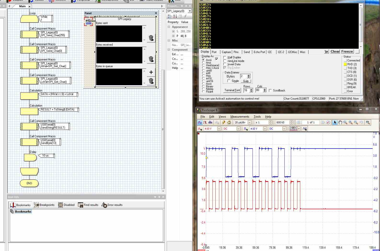

I was going to ask for SPI slave mode to be added to Flowcode5 to take advantage of the fast clock in the AD977. However, by using an oscilloscope and triggering the ADC via its R/barC pin with barCS tied low the fastest the PIC is able to send a trigger is about every 700microsec after cycling through the SPI code(picture 1, which shows the triggered outputs from the ADC). That is without including the USB code for sending the data onwards. The fastest sample rate for 16bit data with a PIC is therefore less than 1.5ksps.
It takes the AD977 about 7microsec to produce each 16bit data sample, a sample rate of about 100ksps, as per specification (picture 2). So most of the ADC's performance is wasted.
So it would not be worthwhile, for my application: collecting geophysical data, to add SPI slave to Flowcode for PIC

- Picture 2
- AD977output_with_internal_clock.JPG (113.04 KiB) Viewed 8313 times
- Picture 1
- ADC output with PIC trigger.JPG (94.58 KiB) Viewed 8313 times

Thanks for the tip about using the ADC clock as interrupt trigger. That might well work. I wonder if I can do that using the PIC's spi registers on the SDI pin.
I see what you are saying. I have tried with both external (PIC as master) and internal clock modes (PIC essentially as slave). There is no flowcode for PIC as slave (It is on "to do list") but the PIC does need to be a slave because its SPI clock is so much slower that the ADC's. With the fastest settings I only get about 150KHz clock frequency from the SPI's SCK pin, which is more suited to temperature or mains frequency measurements than for uploading 500 16bit samples at 20,000sps. The spi clock is supposed to be Fosc/4 at its fastest, i.e. 5MHz with a 20MHz crystal. However, Fosc seems to be less than the crystal frequency by a wide margin. I have no idea why. The datasheet is obscure on this point.
Ben offered some C code on the forum in 2008 to make the spi a slave but I have no idea how to add it to my program or whether its would work.
I have got the USB serial going on the 2553 and I don't think that will be a bottleneck. It uploads data made very noisy by the overlap of the spi clock on the ADC clock, which it suppresses. If I turn the ADC clock off I get no data.

I have modified the flowcode as you suggested, and have included USB this time. The USB shows a stream of zeroes/cr at the correct rate of about 1ksps. The oscilloscope shows that the ADC's timing is OK and that a good if noisy 16bit number is output. I don't understand what .pval is and although I understand the binary operators I don't seem to be picking up the ADC data with your suggested formula. I am using interrupts on the rising clock edge because it gives more time for the bits to be read. The compiler warns that the second interrupt macro may be inaccessible but I don't see why. Your advice on the attached would be greatly appreciated.

Thanks for the interrupt code which, however, I was unable to get working. I don't really understand how the interrupt affects program flow but it seems to disable the Pulse output from the PIC to R/barC to start the ADC. Nothing seems to be output from the ADC as a consequence.
I have been able to get the circuit working with the attached code and this produces valid USB output of zero bits near zero volts input to around 25000bit around 4V input on Vin. See photo. I suppose it is set for a 0-10V scale. I set the ADC to external clock which the PIC supplies in a ragged manner. The timing is: Fosc/4 = 130kHz, Fosc/16 = 50kHz, Fosc/64 = 12.5kHz. Triggered off the R/barC pulse there are 16 clock cycles before, and 24 cycles (apparently!) after the rising edge. However, the clock is extremely noisy and is intermittent or even inactive when the USB is also inactive (unplugged) - which I just don't understand.
