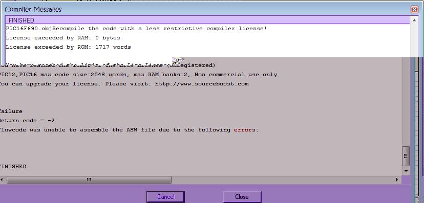

Hi there,
could anybody help what to do when i got this on my compiler message? Anywhere that I can register my Flowcode 5?

Can you please un-install your free version of Flowcode and try to re-install after restarting your machine and see what happened? If still problem persist let us know so that we can have a look..

Hi Jocelyn
The free version of Flowcode restricts the amount of code you can put into your chip, you may have hit this limit, the way to increase this is to upgrade to Flowcode Home/Professional.
