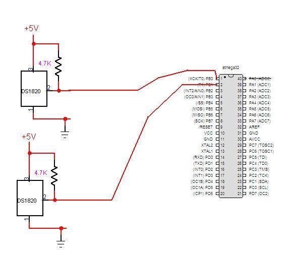

Hello to everybody.
I'm new to the forum.
I have one question. It is possible to the microcontroller ATmega32 create 2 X 1Wire the pin PB0 and PB1?
How to define two input 1Wire?
To better understand the attach picture.
Thank you very much for the answer.
Radojko

You can use two one wire device in the same port pin by using one pull-up resistor but the data line will be tied together and connected to that one pin of PIC..In code we can identify two chip as they have different address.
Re: 2 X 1Wire individual pin on one mikokontroler
Sorry for bad english
I understand that it can be 1wire pin connected more DS18S20.
But it's complicated for me. I would like to skip addressing
I would like to connect DS18S20 on each individual pin.
This connection is much more understand for me.
Any other a suggestion?
If I DS18S20 the individual pin then you can skip address and reading code.
But flowcode but allows only one 1wire one pin.
Use the C code in the project, do not know how.
Any suggestions…
Can you add a second one wire component and connect this to your second pin?
I used the attached file PIC_One_Wire.c. When translated into HEX code return error.
Attach PIC_One_Wire.c C code from Flowcode4. Code works, but I can use only 1 x 1Wire pin.
Beny, or you can check the attached code? Your attached code is not working correct.
Benj, can you please stick also “C” code for AVR one wire.
How you can help.
RR
Again, please help.
I tried 2x onewire in Flowcode5 2x single pin. I use ATMEGA32 microprocessor.
Use sensors DS18S20. Are connected to pinD2 and pinD3.
One sensor is working properly connected to pinD2.
A sensor on the pinD3 shows the same temperature as the sensor pinD3.
How to properly write a program, i measured two temperature?
I attach my program to AVR atmega32.
What am I doing wrong? Please Help.
Thanks and best regards.
