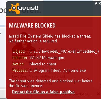

Hi Zane,
I tried to download your file and Avast said it was a Malware and would not let me open it...
cheers
Acestu
cheers
Acestu

Hi Acestu,
You may have read this:
http://www.matrixmultimedia.com/mmforum ... 47&t=12223
Its is a false positive detection, its not the file that was posted, but the Flowcode executable file when you compiled flowchart.
What I did was open Avast user interface, Select Antivirus, then File System Shield, Settings.
Select Exclusions then browse to your Flowcode directory/s path.
You can find path when selecting Build then compiler options.
I also selected all the Flowcode directories for exempt from scanning. Not sure if both steps are required, but did so just to make sure.

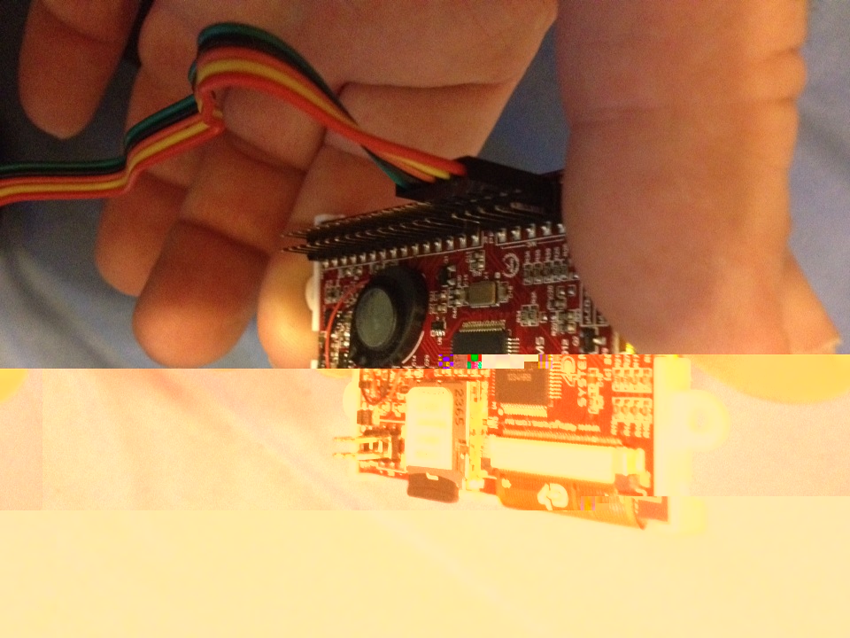

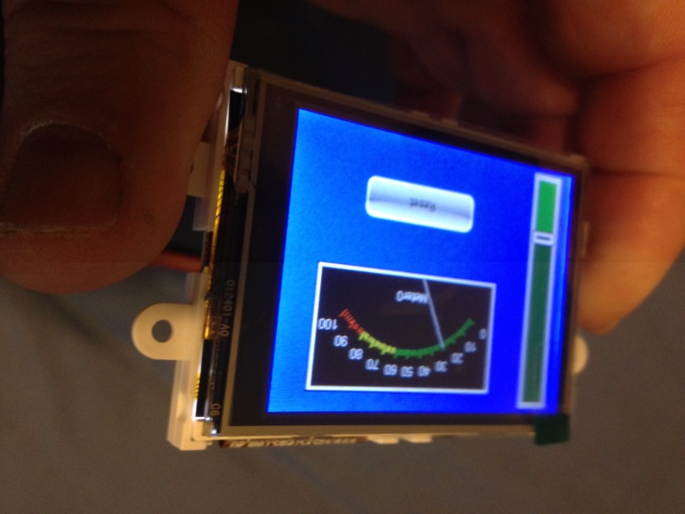

In relationship to the issues I have had getting this newer type display to work I have placed a few notes below to help anyone else who is planning on doing the same to hopefully make life a bit easier.
Before you begin you will need a 4D programming cable and also have the driver installed. You can get that from here
http://www.4dsystems.com.au/product/17/ ... -Cable/The drivers are at the bottom of the page.
Then you need to download the 4D software from here http://www.4dsystems.com.au/group/10/Development/
Once you have done this you will need to download the old firmware version from here. Brandonb has already kindly listed this above on another post.
http://old.4dsystems.com.au/prod.php?id=209 ..... this is the file you need uLCD-32PTSGC-R22.PmmC (HX8347A Driver IC) For other sized displays you will need to go here and find the display type you are after. You need to SGC version not GFX.
Once you have done this you need to open the 4D software (you may need to run this as an administrator for it to work correctly) and create a new project, it is all fairly simple. Once this is done go to the tools menu and select the PMMC loader and load the software.
From now on you should be able using Flowcode and a development board to interface with your display.
Please note that I have only done this using the 3.2" resistive touch screen.
To display images, you can use the drawing instructions to the display via Flowcode or what I have just started doing is using "Microsoft word" to build my displays, using graphics composer to place the files onto the SD card for the display and use flow code to load the files of those images.
To do this I create an image in "Microsoft word" and cut and paste it into "Microsoft paint" and set the page the size in "paint" to the same as the display 240x320 pixels. Once I have pasted the image into "paint" I can get an idea of the size of the image I have created in relationship to the display and alter it accordingly. As for text you can once again use the print command from Flowcode or as I have done is using "word" to create my text strings and saving each one as an individual file to load. That way you can display different type fonts easily.
To load the images you need to get a copy of the graphics composer software. That is located here http://www.matrixmultimedia.com/product ... PHPSESSID=
There is some good info about how to use this on the Matrix website under the display here.
http://www.matrixmultimedia.com/resourc ... blocks.pdf.
I have attached a couple a couple of screens I am building up for a project I am working on that is in the very early stages using the above technique. The Flowcode example files for the EB076 also give you a great insight on how to interface with the display.
Cheers
Zane
