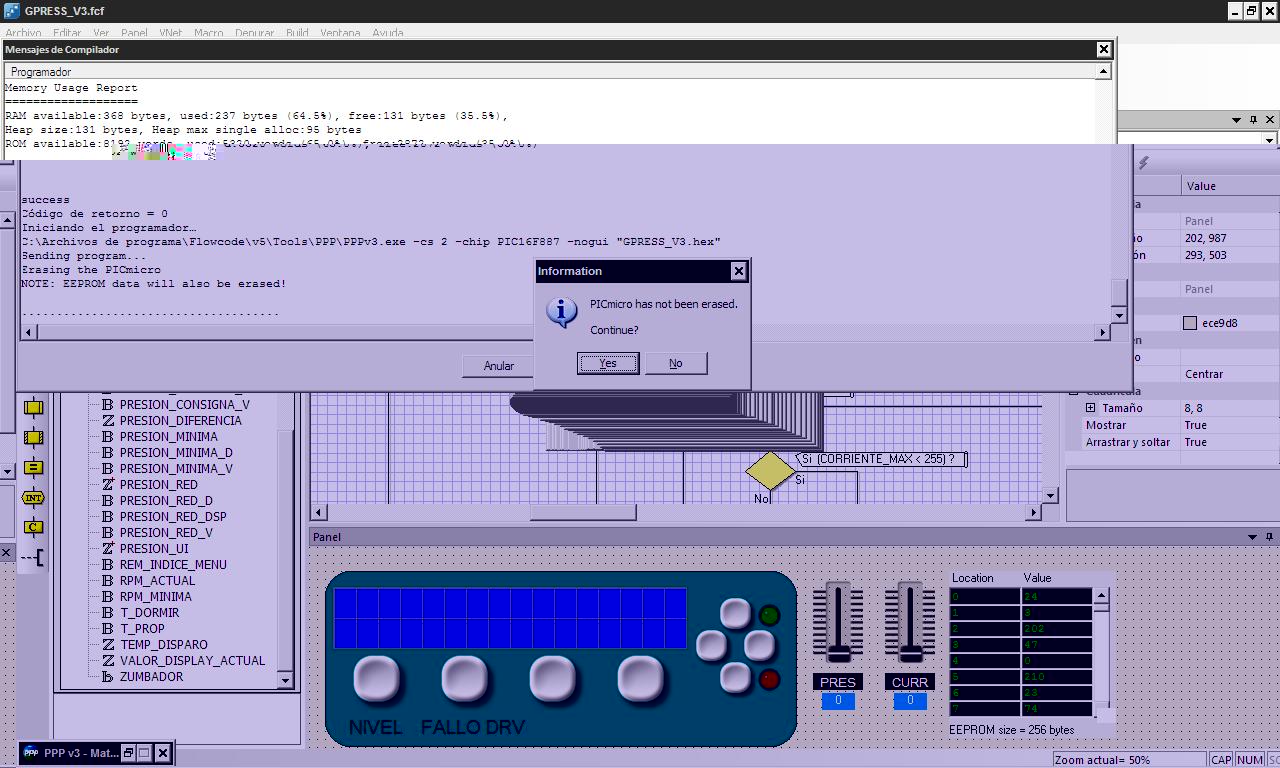

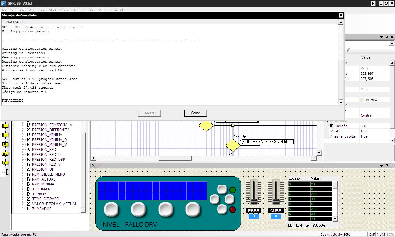

When I want to compile into HEX and send a program to the micro, the first time provides clear failure. The seguna time is all right, someone knows why and how to correct it?
Work FC5 with EB006, external power and PPP programer.
thanks
Erase fault with EB006 and PPP
- second message
- (166.97 KiB) Downloaded 504 times
- first message
- (174.19 KiB) Downloaded 504 times

Re: Erase fault with EB006 and PPP
There are known problems with the detection and programming of the 16F887, it may be a good idea to upgrade to a more modern chip like the 16F1937.
