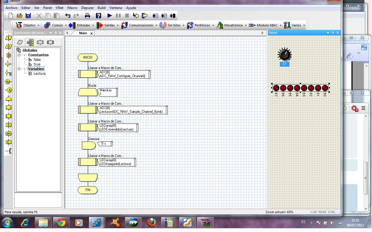

Hello everybody:
I'm trying to configure the EB003-00-2's potentiometer and it's not function. This is the configuration:
Component Properties:
Connect to AN1
Convert Velocity; Fosc/2 (I use the oscillator)
Vref option: VDD (13,3 V)
FlowCode,
(191.15 KiB) Downloaded 2220 times
Thanks you very much

Can you post your Flowchart please.
It's always easier looking at someones Flowchart to see what the issue is.

Hi Martin:
Thanks you very much in advanced.
Sensor.fcf
(14.5 KiB) Downloaded 474 times
Carmen Garcia
Posts: 9521
Has thanked: 2585 times
Been thanked: 3815 times
Re: My RV1 doesn't sample
Hi Carmen, I have changed flowchart to be much more responsive.
I can confirm it works with my sensor board.
If it does not work with yours, then we will need to look at your hardware next.
Can you please let me know how you get on.
Sensor2.fcf
(10.5 KiB) Downloaded 362 times
