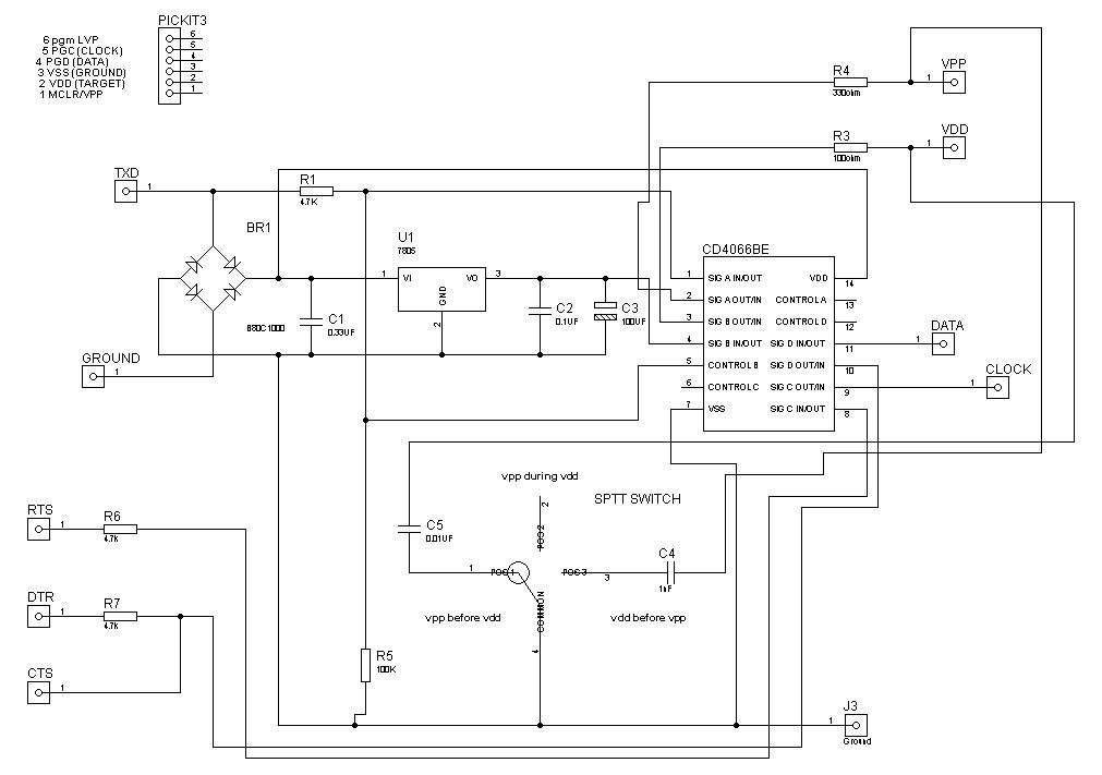

I thought some of you may find this info interesting, it is a pdf document that shows you how to connect and disconnect your ICSP header automatically using a quad bi-lateral switch...

I don't know if anybody has looked into this yet but I have a few questions if anyone can answer them please:
I would be connecting a pickit3 programmer and the connections are: 1. MCLR/VPP 2. VDD Target 3. VSS Ground 4. PGD 5. PGC 6. PGM/LVP
1. What are the TXD,RTS,DTR,CTS pins ?
2. Why is the VDD of the 4066 connected between the bridge rectifier and the regulator ?
thanks
Acestu
Laptop Mac Book Pro i7 retina El Capitan //// Tower/Intel i7-Windows 7 64 Bit, Toshiba i5 Laptop Windows 10
Computers are like air conditioners. They work fine until you start opening windows.
Kenrix2
Flowcode v5 User
Posts: 211
Joined: Tue Feb 19, 2013 9:51 pm
Has thanked: 72 times
Been thanked: 177 times
Re: Automatic ICSP Disconnection
Post by Kenrix2 »
1. They are the serial port pins on a PC.
2. To provide the high voltage required for programming.
If you already have a PICkit3 I am not clear why you would want to build this unit? What software does it use? It is a very simple design though, quite clever.
Posts: 9521
Has thanked: 2585 times
Been thanked: 3815 times
I agree with Kenrix2 if using PICkit3 you will not require the bridge, 4066 etc.
This is because the programmer circuit was designed around TXD which went negative when not in programming mode whereas with PICkit3 there are no negative voltages when not in programming mode.
What I do for ICSP is directly connect all connections from programmer to target device.
Use 10k resistors for connecting data and clock pins from target device to rest of circuitry e.g pots, switches etc. Will be ok so long as used for either an input or souring high resistance output. So not suitable for driving LED's direct.
Not tried with LCD, in theory should be ok?
Finally I would use a 10k resistor and a diode in series from VDD to MCLR. anode connected to resistor and cathode connected to MCLR.
I have use this method with pots as connected to programming data and clock lines. since analog i/p has high resistance, the 10k resistors had no effect on the analog value.

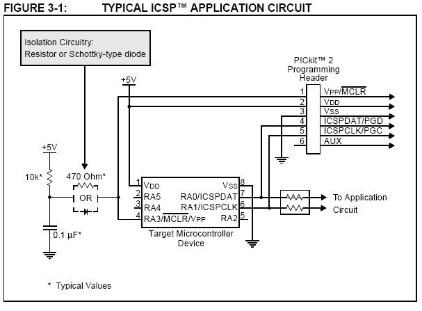

Hi Martin,
I have just found this pic, is this what I am looking for ?
thanks
Acestu
Posts: 9521
Hi Stuart
acestu wrote:I have just found this pic, is this what I am looking for ?
Yes that's exactly what your looking for!
