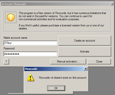

I can not activate the Flowcode6 beta version.
I tried online and manually.

Re: Activation not working on apple computer.
Hi Stibor
have you followed this thread
http://www.matrixmultimedia.com/mmforum ... 53&t=12619
Dazz
Dazz
