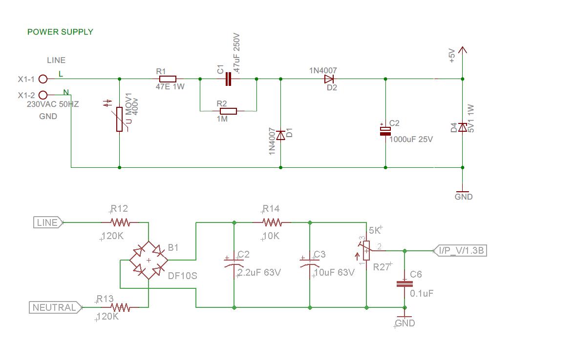

Hi Martin,
i am extremely sorry for such long delay to update you.. :cry:
i have attached the image of power supply used for microcontroller and voltage divider circuit to read from mains.
if live and neutral connections as exchanged then there is a chance of shock hazard in this circuit as power supply is of capacitive type.
how can we prevent this shock hazard?
Prashant
