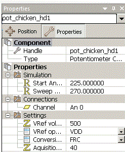

Come on, is just a ADC conversion, whats wrong in the hardware?
I should be easy.
I should be easy.
- (159 KiB) Downloaded 2002 times
Re: ECIO40 ADC TO LCD 4 LINES
please find attach. simple software and adc config
- adc config.gif (15.77 KiB) Viewed 13889 times
- simple adc.fcfx
- (6.26 KiB) Downloaded 228 times
