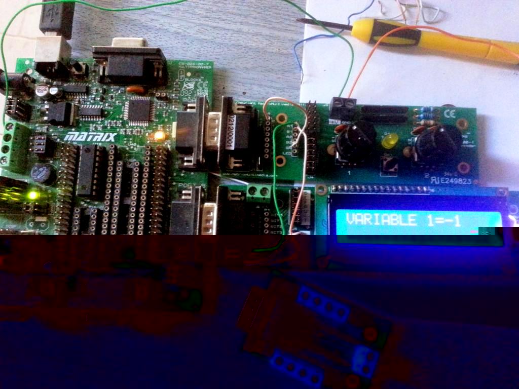

I changed the connections for the components to use your`s HW:
- EB006 E-blocks Multiprogrammer Board
- EB073 E-blocks Rotary Encoder Board
- EB005 E-blocks LCD Board
but the rezults are the same...
- (135.55 KiB) Downloaded 2084 times
