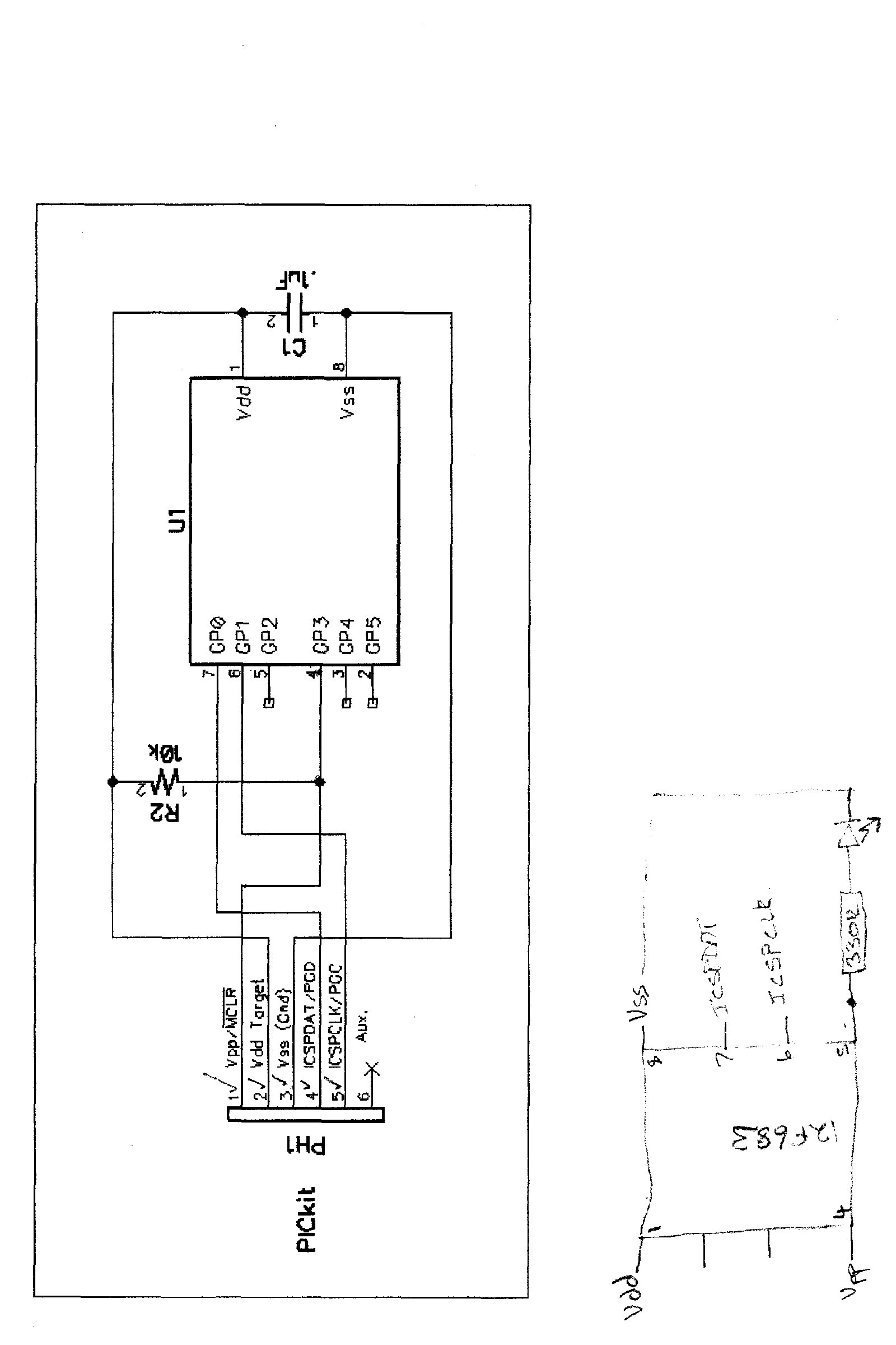

Attached is the schematic I'm using to program the 12F683 ICSP with a PICkit2 programmer.

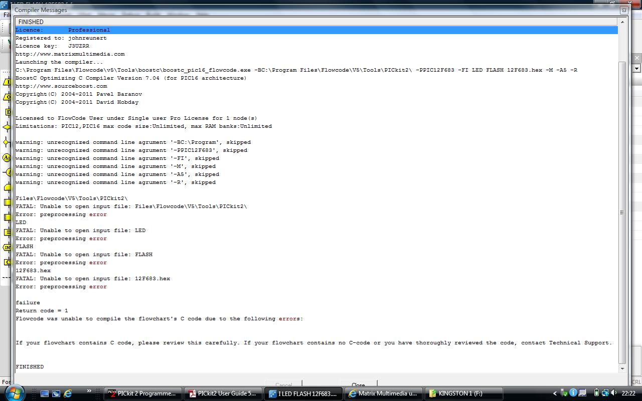

When I try to compile to HEX I get the following errors/messages;(Attached)

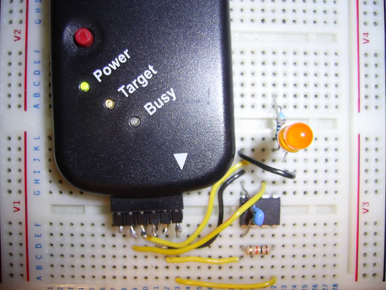

I've also attached a photo of the actual board wiring incase somebody can spot what I have done wrong.

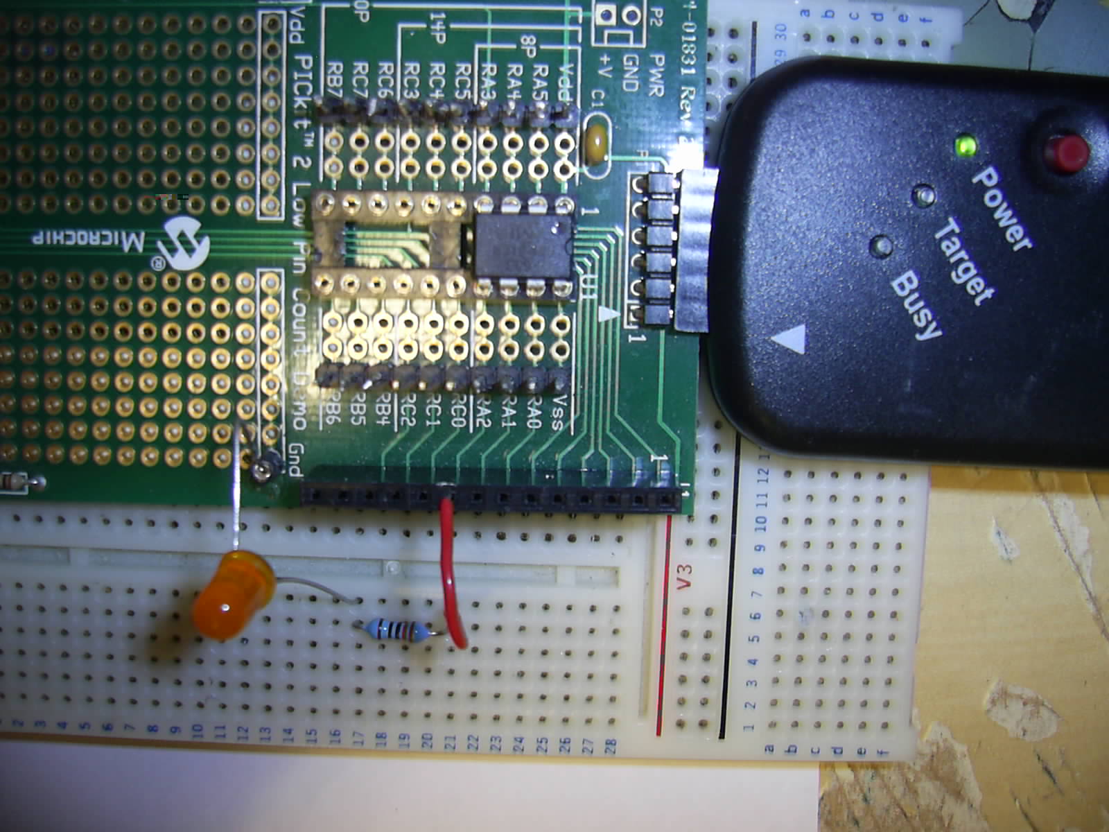

I discovered that my MICROCHIP LOW PIN COUNT BOARD can also take the 12F683 so I have inserted it into the socket that once held the 690 chip.
Now, when I use the compile to chip button the TARGET and BUSY light on the PICKIT2 programmer come with the BUSY red light flickering which indicates to me that its programming the 12F683.Ithink??
However, when I run the simulation program, the LED on pin 5 does light up but does not switch on and off. I checked the chip using the PICKIT2 program and the chip appears to be empty, nothing,zip. But if I import the hex file using PICKIT2 program it does write the program to the chip but still the LED does not switch on or off.
I've attached a photo of the new setup and also the program file for your info.
Any ides please. Thanks a lot.....again - John

Hi John,
Two things.
1) If there is not a pull-up resistor connected from Pin 4 (MCLR) to +5V then you will need to go into the configuration screen and change Master clear enable from external to internal.
2) If there is no external crystal then you will need to go into the configuration screen and change oscillator to internal RC.
If you plan on running at the default 4MHz, then just change clock speed to 4000000.
If you would like to run the chip at a faster 8MHz, then you will need to do two things
A. Change clock speed to 8000000.
B. Add a c code block at the beginning of main (before loop starts) with osccon=0x70;

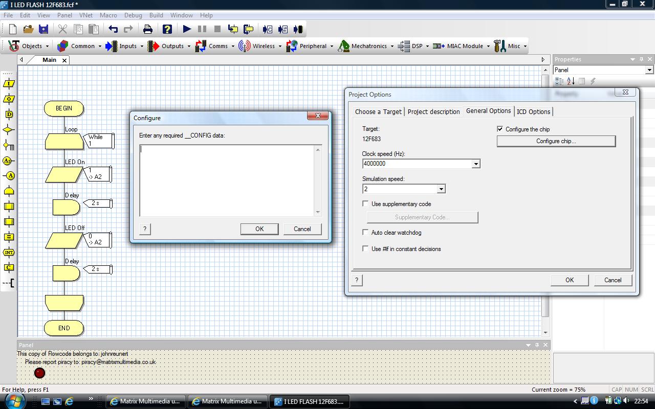

Now when I go to build>project options>configure chip......nothing but a small bland box comes up. Never seen it before. Usually another window came up with all the chip settings??
Have attached the screen for you to look at.
Thanks again - John

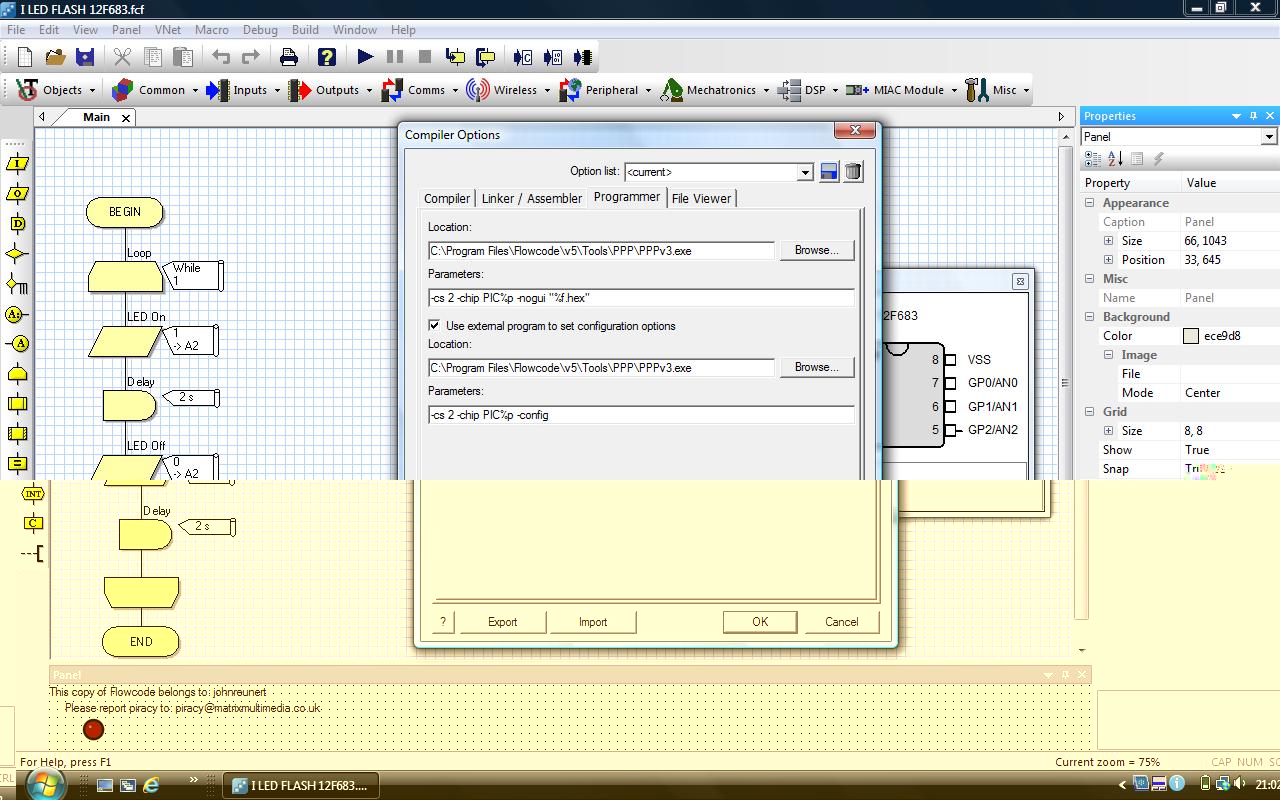

Posts: 9521
Has thanked: 2585 times
Been thanked: 3815 times
Re: ICSP 12F683 Not Working
Hi John.
You will need to go to 'Build' menu, select 'Compiler options', then click on the 'Programmer tab'.
Make sure you have 'Use external program to set configuration options' ticked:
(75.02 KiB) Downloaded 8734 times
kersing
Posts: 2045
Location: Netherlands
Has thanked: 553 times
Been thanked: 1081 times
Post by kersing »
Hi John,
Take a look at the Compiler options, Tab "Programmer". Is the tick next to "Use external program to set configuration options" set? And does the Location just below it point to PPPv3.exe? If not set and change location to "C:\Program Files (x86)\Flowcode\v5\Tools\PPP\PPPv3.exe" (Or C:\Program Files\Flowcode\v5\Tools\PPP\PPPv3.exe for 32 bit versions of Windows)

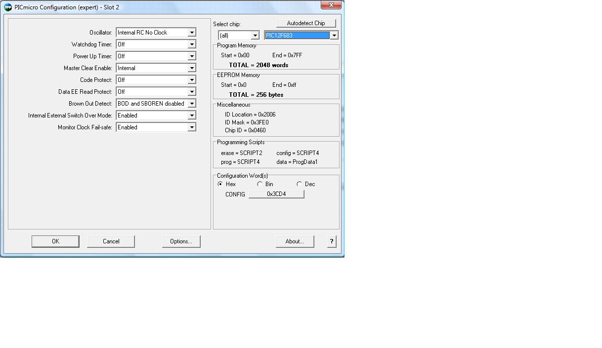

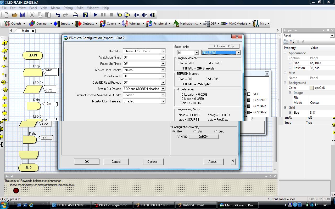

Thanks guys, sorted that out after I had sent the post. Checked Jac suggestions and all is correct there. Still no joy.
I have attached a grab of my chip configuration settings for you to check. Most probably screwed something up here.
Appreciate your guys help Thanks again - John

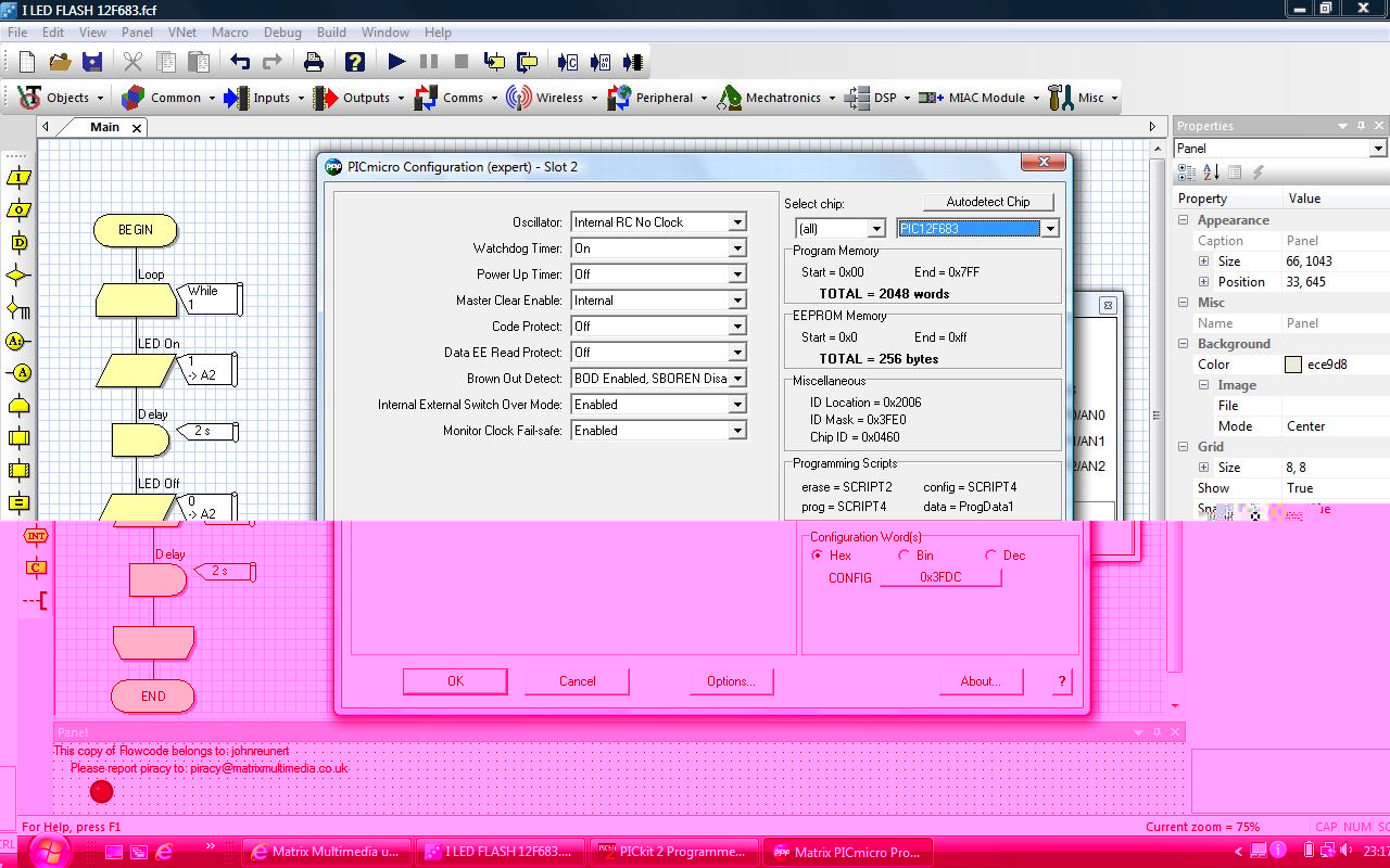

kersing
Posts: 2045
Post by kersing »
Try setting Watchdog Timer to Off. Also disable Brown Out Detect.
― C.S. Lewis

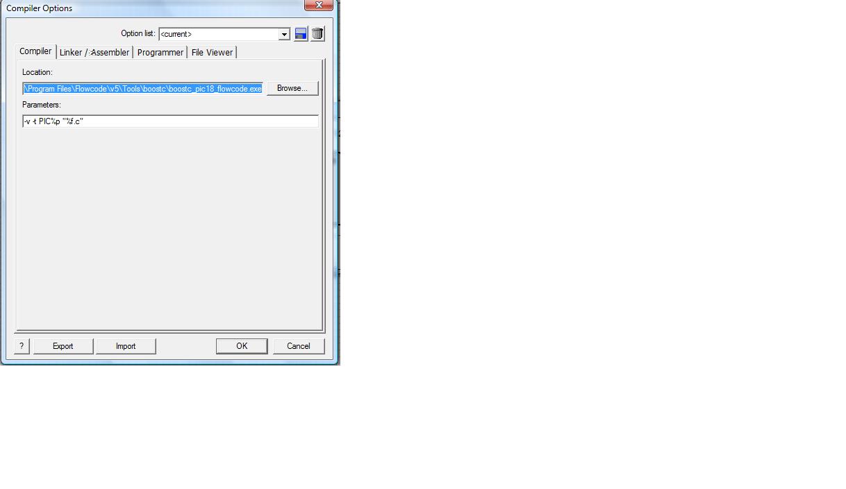

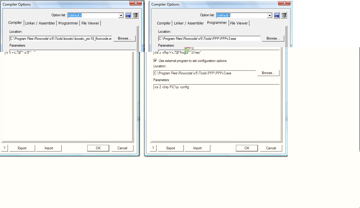

I'm curious to know why FLOWCODE5 keeps saying it has compiled to the chip OK but when I check using the PICKIT2 software there appears to be nothing??
OK, so what I have done now is attached screen grabs of all my settings in the hope you guys will spot what has gone wrong.
Thanks very much for all your help so far. John
Your middle picture shows the problem. The compiler is set to call the PICkit executable. That is certainly not right.
First of all reset to the defaults and this should allow you to compile to hex correctly. Once you have this working you can start worrying about the PICkit settings in the "Programmer" tab.

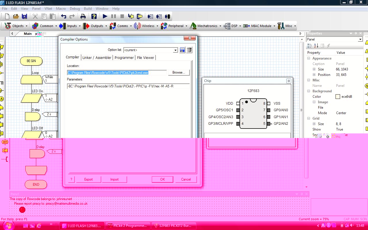

Thanks for your help Benj.

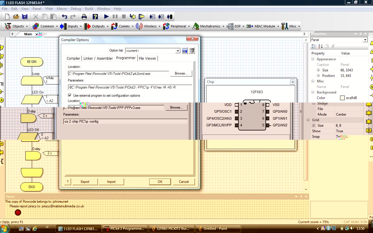

I've reset the compiler settings to default and provided a screen grab of the compiler settings now. I have also attached a screen grab of the programmer settings as they are at the moment for you to check.
Really appreciate your input. John

kersing
Posts: 2045
Post by kersing »
John,
Looks right, now you need to change the settings in the programmer tab (and only in that tab) to the ones used for PICkit.
Regards,
Jac

Thanks, there is some progress. I managed to program the chip after making the changes Benj suggested. Only thing is I used the PICKIT2 software and it works!!
I'll check out the programmer settings as suggested by Jac and report back. Thanks guys - John

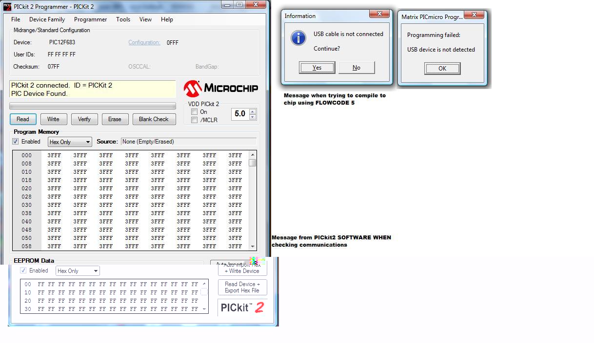

OK, now I'm getting messages that theres a problem with the cable and the USB device is not seen? I checked the communication using the PICkit2 software and all seems to be OK?
Ive attached screen grabs so you guys can check it all out. Man this is becomming harder and harder. Hopefully nearly there.
Thanks a lot guys...John

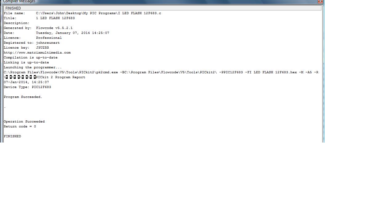

Here is a screen grab of the message I get when using FLOWCODE5 Compile to chip but still nothing happens.
Could somebody explain to me why after this message the chip is not programmed to work with the simulation?? When I push the compile to chip button I can see the TARGET light on the Programmer come on and the BUSY red light flickers for a brief period. Hope that means something.
Oh, the problem with the cable and not recognised USB device seems to have gone away. Dont know how or why. The only thing I did do was enabled the Boran etc in the chip configuration part.
Thanks a lot, really appreciate your time and patience- John

Posts: 9521
Hi John,
from your screenshot it looks like Chip has been successfully programmed.
Out of curiosity, does LED light if you remove read lead from RA2 and connect it directly to + 5V?
Also can you measure any voltage present between RA2 and 0V?

RA2 (PIN5) has 2.8V pk-pk on it. The only time this goes up to about 4.2V is when I open up the PICkit2 software and tick the Vdd box. The program then runs and the LED flashes. but not in sync with FOWCODE5.
Not sure what you mean by "disconnect the read lead!". I've got the PICkit2 programmer connected to a low pin count board so I can only disconnect the whole programmer. (Attached photo)If you could tell me which is the "read lead/pin" I could scope it for you and see what happens if that helps at all?
Dont know if this helps you at all, but there is also no voltage at pin 1?

from your last post it seems all is well, as with the pickit2 you have to select the vdd on to power the target board, the power light on the pickit is there to let you know the pickit2 is powered , the target light, lights when the vdd is selected on in the software and then provides power to the uc board

Sorry was a typo, it should had said red lead i,e the lead connected to resistor/LED anode.
It's to prove that LED and +5V are correctly working.
Issues sounds to me that pickit is not configured to power device after programming has finished, which is what Dazz is saying.
I totally agree.
To leave power switched on you will need to use the -T option in Programmer parameters. e.g:
-BC:\Program Files\Flowcode\V5\Tools\PICkit2\ -PPIC%p -F%f.hex -M -A5 -R -T

OK Folks, I did the adjustment and it now appears that the program is going into the chip. LED is flashing.
The only thing is it seems to be on its own mission as I cannot control it through the FLOWCODE5 controls for the flowchart. pause, stop etc.
