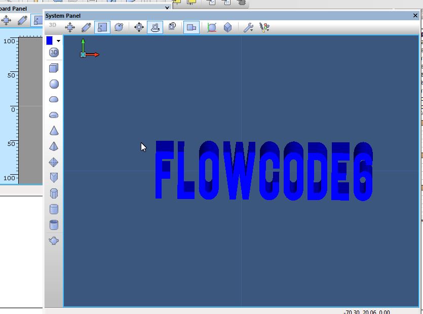

Hi Jonny,
The Wavefront OBJ file is importing fine, I tried it after I found your post above thanks,
thanks
Acestu

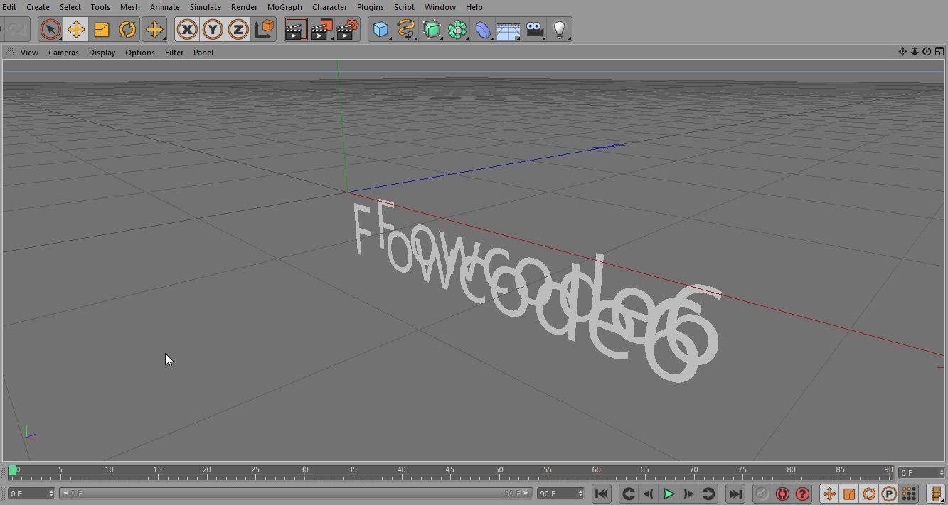

Basically my first test file in cinema 4D ws just the word Flowcode in Mo Text then exported in OBJ format, this causes flowcode to crash, I am including a pic and the file:
Acestu

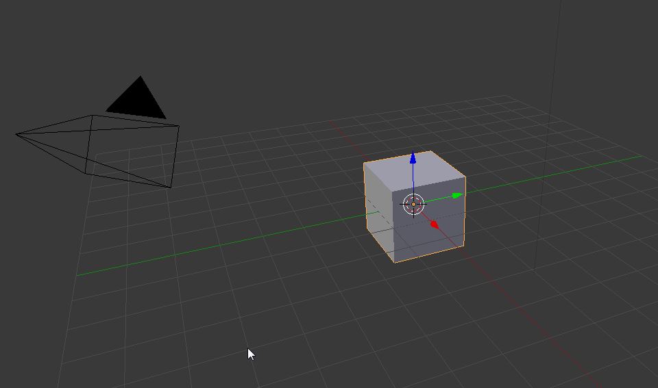

I have just created a simple Cube in Blender and exported as an OBJ file, when I drop that onto flowcode the same thing happens the panel appears but when you click ok ie crash:
Acestu

Hi. The only things I can see is there is no normal or texture information in the file, the faces are not triangulated and the 's' option on the converter is currently ignored. Hopefully I get the same issues here and it is a quick fix - the cube causing the same issues makes life much easier!
Jonny

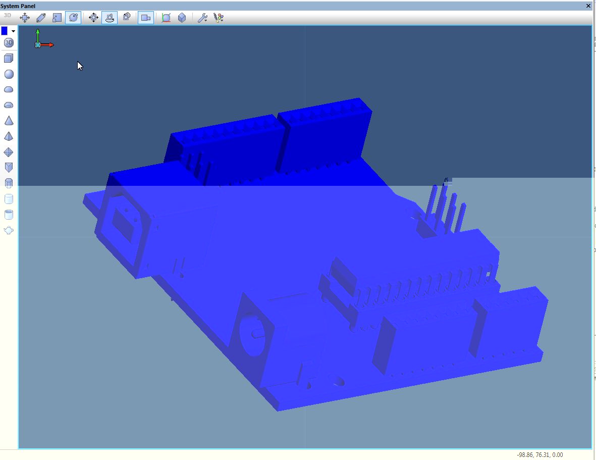

I have successfully imported a Solidworks model into Flowcode6:
Basically I saved my model in the STL format then I imported it into "Meshlab" which is a free app available here- http://meshlab.sourceforge.net/ and then I exported it as a Wavefront OBJ file, then if you drag it onto FC6 then it will import fine.
cheers
Acestu

Just an update, I have just tried importing an obj file from Cinema4D64 after setting the options box after dragging on the file, Flowcode crashed and closed...
cheers
Acestu

Re: Importing a Mesh from Modelling app
I was able to import the stl from Solidedge with this options:
The dimensions in mm are still correct
