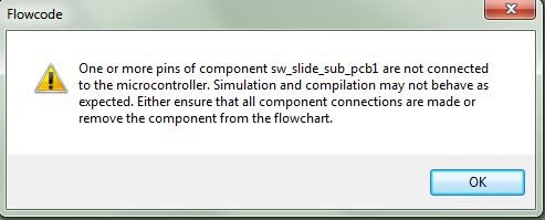

The problem is that the new shape switch does disappear in the sense that I could not see it but when compiling FC generates an error stating that some pins are not connected. Only by selecting into the area I found that the component is still there and I needed to delete it to resolve the error on compile.If you don't like the style of the switches on the 'Array Base'...

Apologies for the errors - you should not be seeing the 'pin unconnected' message.
As you say, the chosen 'switch shape' does need to be in the panel (but hidden), so that the component can see the 3D shapes and make copies for the array. The flowchart WILL still compile with the 'hidden' switch/LED, as the unconnected pin is intentional, and the macros for the 'hidden' component are never called by the array - compilation should complete successfully if you just dismiss the warning. (Of course, if this is not the case for your choice of PC or target chip, please let us know!)
This was the best way that we could find to make arrays of 'cloned' components with customisable graphics that would retain compatibility with old v5 projects. However, we are aware that it is not ideal, and is something that we will be looking into during the next phase of v6 development (the unnecessary warning message at least should be suppressed! - I'll try to get that fixed for the next update).

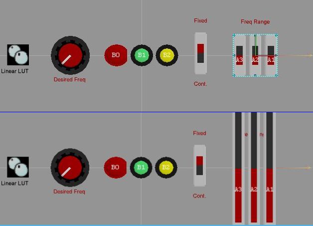

Another follow up on this topic... this happens after I shape and size the switch array so it looks like the mage at the top of my attachment. The I save and exit FC and restart FC (like in "calling it a day and coming back next day")
Well, as you can see the shape stays but the size does not, it is either way smaller or way bigger (I am only showing the bigger). I can change this by selecting the switch array component, access Properties/Position and editing the World Size / Height but the fact is that it should remember the size it was saved with, right?
Also, I though that I "resolved" the error reported by actually connecting to some pin the "invisible switch" used for shaping. This is not saved either, so on restart it is disconnected and will trigger the error once again...
All things are related and probably once one is fixed the others will fall in place as well. Hope this helps pin-point where the bug is hiding.
