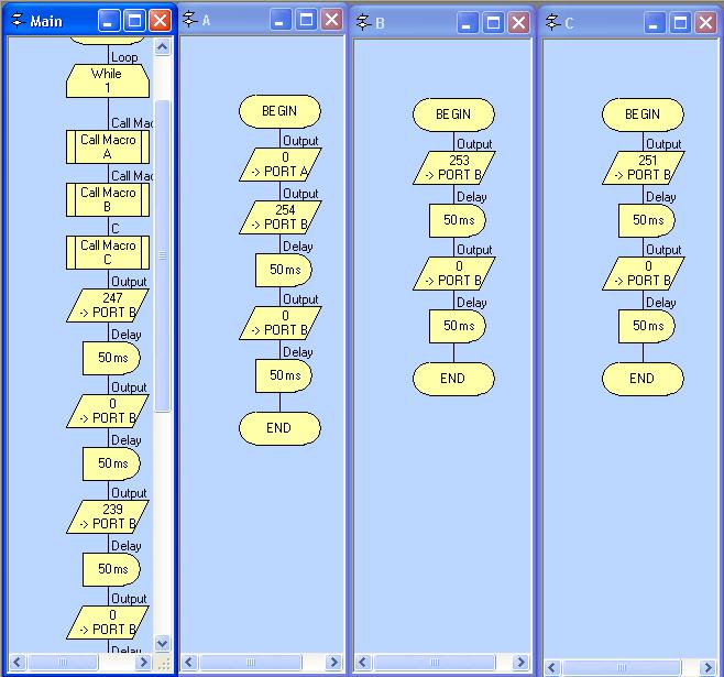

This is how i display col0 to col5 1 by 1 , whn i use the same output on port A , the row5,6,7 lights up tgt ... pls help

. The version of flowcode is V3.6.11.53. My purpose is find out the output for every single LED. SO i try to light up each col and row first. This is the output i found for COL0-7
(due to using demo version of flowcode, the outputs can be used are limited ). Output for col6 and 7 are 191 and 127. When i try to light up row0 with the output of 254 at port A and 0 at port B, the led at row0 light up but also led at row5,6 & 7
flowchat row0.jpg (6.32 KiB) Viewed 41352 times
. Please help TT
