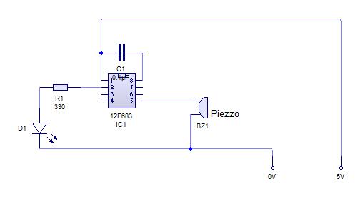

Hi Martin, tried opening the hex file you sent and got a message saying access was denied. Tried opening other hex files and got the same message??
Here are my other settings
Clock speed 4MHz
Using INTERNAL NO RC CLOCK setting.
PIN 5 is left open, nothing connected to it.
I have attached my schematic so far.
Any ideas why I cant open up the hex file???
Thanks again .....John

Re: Masking Problems??
Hi Martin, just to let you know I deleted the old hex file and dragged your one into the folder. Then burnt the chip and it worked...well almost,I just got excited when I saw the LED flash twice with the buzzer. Man I'm turning into a flowcode addict.
The only thing now is the LED after the first initial two activations keeps comming on for a 1 second duration and does not stop???
Any ideas on this and what you think went wrong initially???
Thanks a lot...John
Thanks a lot...John

If your hardware is same as circuit then the problem will be down to missing pots.JDR04 wrote:The only thing now is the LED after the first initial two activations keeps comming on for a 1 second duration and does not stop???
The inputs on the microcontroller (that pots should be connected to will be floating.
So any electrical noise will be converted into a value.
You can confirm this by right clicking on both ADC components, select Disable icon
Make sure configurations are set correctly.
