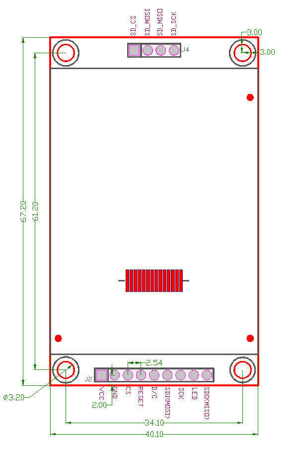

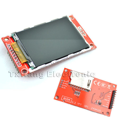

I have received 2.2" TFT GLCD with SPI Interface (http://www.ebay.com/itm/200939222521?ss ... 1439.l2649) but can not find the way to connect it. Can you help?

the display has to be connected to 3.3v both the vcc and the spi require this voltage, you can either buy a ready made level converter or buy a cd 4050 to get the 3.3v inputs, also use the 3,3v pin on the duemelove to pover the tft and to power the level converter

thank you so much for replying. My problem is also connecting other pins. Should I use gLCD EBM001 (or what) and how should I connect it? There is no "A0" or "Data" pin on the display ( which are present in EBM001 connections properties) but instead I have D/C, SDO, SDI pins. Should SDI be connected to "Data" in EBM001? What should be connected to D/C? Do I have to use specific pins on Arduino Duemilanove board?

I think the closest will be the eb057 although its a different size, dont try it using 5 volts, but best bet would be to find the datasheet with the commands on and see if matrix can make a component for it
