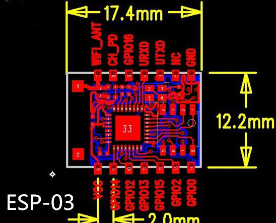

Rudi, did you get any ESP-03 with on board ceramic antenna?
How do you wire them up? There is no reset pin from what I have read
I got 5 in the mail the other day and want to try them out.
Re: WiFi Communication with ESP8266
sorry for delay..
ESP-04 without ceramic, GPIO15 must connect to GND
I will try asap connect ESP-03 ,
I have here too
ESP-01
ESP-03
ESP-04
ESP-05
ESP-06
ESP-07
ESP-08
ESP-09
i play just in time with ESP-04 and the GPIO4, GPIO5 and ADC ( TOUT PIN6 ).
ESP-04
VCC
GND
CH_PD -> VCC like the ESP-01
GPIO15 -> GND
URxD
UTxD
best wishes
rudi;-)
http://www.esp8266.club/technic/reference.txt
http://www.esp8266.club/technic/ESP8266 ... _01-11.pdf
sorry for delay..
I have here too
ESP-01
ESP-03
ESP-04
ESP-05
ESP-06
ESP-07
ESP-08
ESP-09
ESP-04
VCC
GND
GPIO15 -> GND
URxD
UTxD
best wishes
rudi;-)
hyperion007
- Posts: 528
- Joined: Sat Dec 01, 2012 1:23 pm
- Location: Sweden
- Has thanked: 49 times
- Been thanked: 101 times
Thanks Rudi.
Let me know when you have tried the ESP-03 and what pins go where.
Thanks.
Thanks.
ESP-04 done:
i will make same with ESP-03 now..
RST
push GPIO16 short to GND and release it again.
Flashmode
If you want in Flashmode,
so push GPIO0 to GND
and push GPIO16 to GND, release it
now you are in Flashmode, you can release GPIO0 now too
Boot normal Mode
If Flash ok, the ESP will boot byitself,
if you take other Flashprog perhabs esptool from mamalala
this support pin switching by software in newer version.
At XTools can be: you must push GPIO16 to Gnd short ( RST ) and release for reboot.
Let me know how you get on
i added the finnish in ESP-04, same i will do with the ESP-03
I will add a pigtail to the ESP-04 and extern Ant
I have connect CH_PD by a jumper to Vcc+
the GPIO15 i have connect by a jumper too but to GND
The Flash Button simple parallel at GPIO0 and GND, it is a "closer pusher"
The RST Button simple parallel at GPIO16 and GND, it is a "closer pusher" too.
Best wishes
rudi
btw
http://s.zeptobars.ru/ESP8266-HD.jpg
ESP-04 done:
RST
Flashmode
Boot normal Mode
Best wishes
rudi
btw
hyperion007
- Posts: 528
- Location: Sweden
this will be the same for the ESP.03
because:
gpio15 is mtdo and must actually when not in SPI slave mode, low be at boot.
It has a Waek pullup, but on the basis of the mtdo function (because the boot is on input)
every now and then to weak is, so it may be that the esp8266ex but from spi flash in standalone
fashion Botet although no external pulldown depends on mtdo.
hope this helps
the one thing with EXT_RST PIN32.../ GPIO16 Pin 8 and Deep-Sleep Wakeup ( XPD_DCDC )
usually pin 32 ist the RST hardware pin..
but at ESP-03, ESP-04 and other.. GPIO16 is descripted as a HW RST ( WakeUp..)
I am not sure if the GPIO16 pin is the RST pin, because Chip picture shows Pin 32 as a EXT RST
but documents said it is a hardware RST pin, you can try it.
china description is not light but will give a hint - deep-sleep wakeup..
..try it! you will get the result like you want.
at my pic it is functionally like i posted
hope this helps
best wishes
rudi
btw:
i will start work at esp-03 at evenning - will same procedure like i made in esp04
because:
hope this helps
hope this helps
best wishes
rudi
btw:
