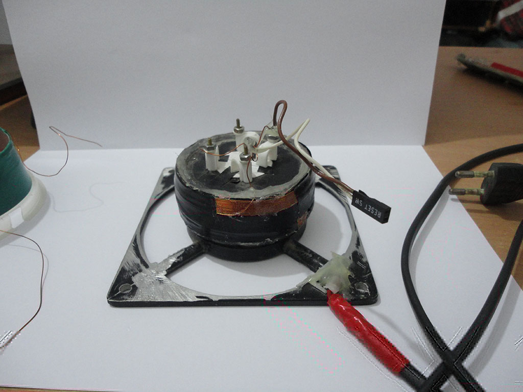

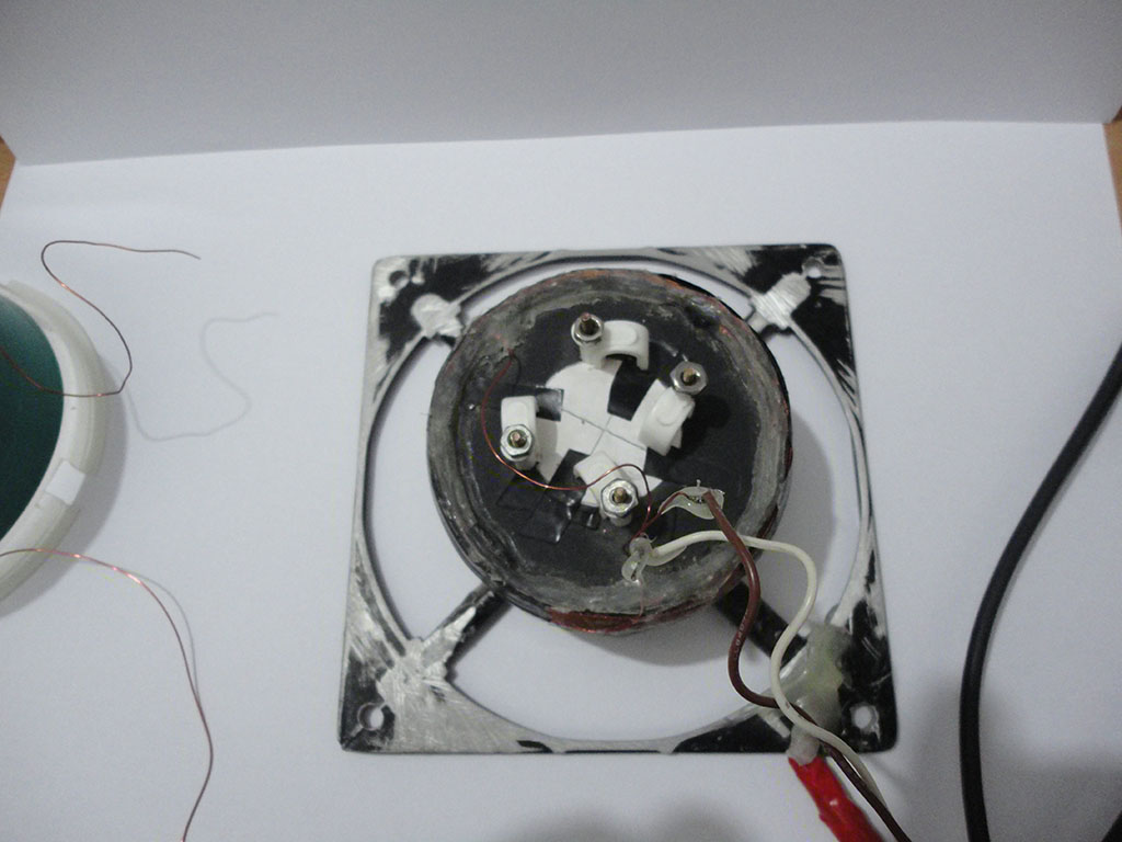

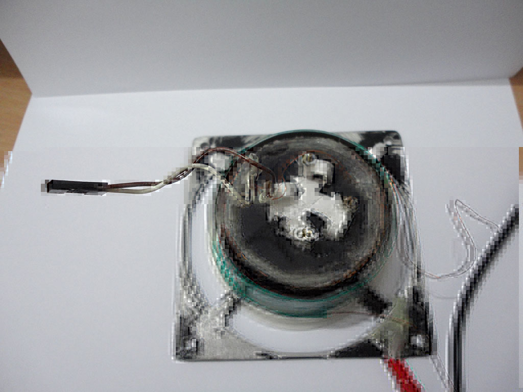

i used motor for old big printer ,this is motor picture :
(102.76 KiB) Downloaded 10188 times
(112.02 KiB) Downloaded 10188 times
(119.13 KiB) Downloaded 10188 times
and In Shaa Allah , the wireless power in the next time will explain how to build it . :arrow:
