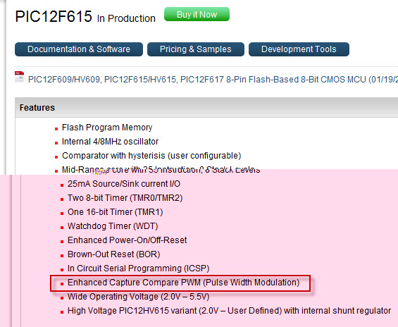

Your PIC has a CCP/PWM which is designed to do things as you want to do measure a pulse/duty cycle/low or high Pulse time etc it is just a matter of configuring the CCP module
Check the data sheet for the device section Capture Compare it will help you to achieve your goal.

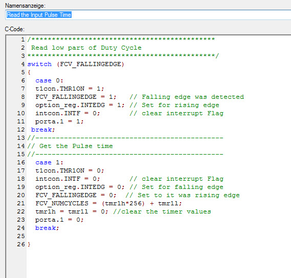

I do not have a PIC12F615 however I have a PIC12F675 and played a bit with you idea.
what i did as you will see I used the INT0 pin on the PIC to measure the input Pulse,I set the Interrupt to occur on the Falling edge and then I start Timer1 and set the Interrupt to occur on the rising edge
in a state machine I check if it is the rising edge then i stop the Timer and I read the time value(this corresponds to the low time of the pulse,to read the high time of the pulse you just need to switch the interrupts to occur
Rising edge -> Falling edge .
I used a 10Mhz crystal that gives me an 1 timer cycle as 400nSec and a pre-scaler 0f 8 which then equals 8*400nSec = 3.2uSec
to get the pulse time it is calculated from the timer cycle value which you read after the rising edge multiplied by the 1 Timer Cycle time
Pulse Low time = 3.2uSec * Timer Value read after rising edge example for 5msec low time I measured 1563 in the Timer1 then 1563 *3.2uSec = 5.0016 mSec
To test if the Interrupt follows the input signal I switch GP1 in the Interrupt falling and rising edge as you will see in the scope print GP1 follows the input signal 100% therefore I am sure the Interrupt is functioning correctly
and I measure the signal low time correctly.The red trace is a 100Hz 50% duty cycle input signal and the yellow trace is the GP1 which get set as it follow the Interrupt and the Input signal (the low time is inverted)
you just need to read your analog signal and do the maths and run the output pin as you would like
I hope this helps you

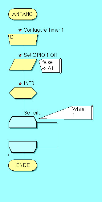

What I suggest you do is try to build upon the project I posted with your own code and post it here when you have problems and all of us can try to help you ,
this way you will learn FC and me too
Here is the C file I used for the pulse measurement anybody else with a better solution please let us know

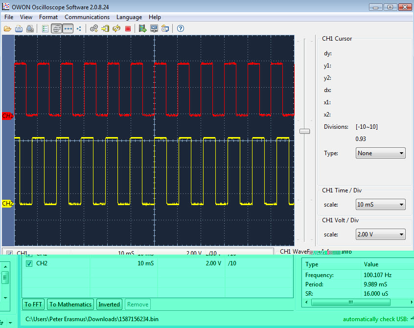

I have modified the project I added some code that outputs a pulse corresponding to the Input pulse low time
all you need to do now is do the maths and load the timer value and you have your pulse
this code should give you a kick start ,
There might be small problems as you go a long as I did not invest a huge amount of time to test all possible issues,however you will see the idea how to do this
The screen print shows in Red the input pulse which the low time is measured and the yellow is the output pulse corresponding to the low time,it a matter of maths now
you can add-scale divide do what you want to get the pulse length you want
Let us know how you get along

I have no idea why you cannot open the project files in FC6 Demo.
maybe one of the experience FC guys can help us with this problem
The timer is set up by setting the pre-scaler value that it would not overflow for a pulse between 1-5mSec this way when you stop the timer and read out the TMRxH and TRMRxL registers you gave the exact time in Timer cycles
then multiplying the cycles with the Timer Constant of 3.2usec you have the pulse time in mSec. The Timer Constant is given by the FOSC and pre-scaler value you use.
I send you the Project document to your email address given above
hope this helps

This does not use the CCP/PWM module at all, it uses the Interrupt feature on GP2 which interrupts when an signal edge is detected and you can specify which edge it should interrupt on then in the Interrupt service handler/Routine you start and stop the timer depending on the edge that triggered the Interrupt.victor336v wrote:all you need is to start a timer when a pulse arrives (can be on interrupt, or if the input continuously polled in the loop), and count amount of overflows by the time pulse ends. This can be
done with standard blocks, I see some examples and exercises using this (just don't seem to be able to combine them to do what I need). This does not involve CCP or PWM functions of the chip, although it probably can be done this way too.
