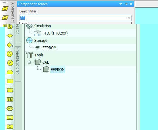

If you go to the search panel and enter EEPROM you will find it

Yes Kersing is correct in my original post you will see both the EEPROM functions it is only by accident that the CAL one is highlighted you should read the help file for each component which will tell you the function of each of them
