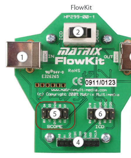

I after working with EB006V9 a while ,I would like to move on with my project to my custom board and are interested in getting a FlowKit,after reading the datasheet there are a few point unclear to me and
would appreciate any help
(1) In one section it mention you need to program you device with your programmer and then use FlowKit for debugging ,on the flow kit itself is an switch that says ICD -Program
what is the real situation can the flowkit program a PIC and dsPIC or only debug.?
(2) The scope pins on the flowkit are they active can they read an Analog or digital signal on a Micro pin as in the case of the EB006V9 ?
(3) Can I use the Flowkit to debug my ECIO40p16 which I program over the Matrix boot loader
@Ben you mentioned that early this year you will release a new ICD programmer board for dsPIC is this still in line and how will this effect me if i buy the Flowkit now and then the new board is released or will flow code still be the unit to use for custom boards and the EB board for hooking up E-blocks ,I am asking because I have no problems spending money on Tool however to duplicate then i also do not like .
I appreciate any feedback .

The Flowkit is a debugger only. The function of the USB out and Prog / ICD switch is to allow simple debugging and reprogramming of Matrix hardware such as the Formula Flowcode, MIAC, Locktronics PIC etc without having to keep plugging and unplugging cables. Switch to program mode and the USB connection is passed straight through for re-programming. Switch to ICD mode and the USB connection is piped to the chip on the FlowKit and the ICD pins are then connected to the slave MIAC/ECIO etc by utilising the second USB connection.(1) In one section it mention you need to program you device with your programmer and then use FlowKit for debugging ,on the flow kit itself is an switch that says ICD -Program
We are currently working on a Flowkit v2 with Ghost functionality, at the moment the Flowkit can only do ICD within Flowcode. We did create a standalone VB application which should be lurking on the forums somewhere which works to give you two analogue traces and 6 digital from the Flowkit but this was never very useful due to large limitations in the application.(2) The scope pins on the flowkit are they active can they read an Analog or digital signal on a Micro pin as in the case of the EB006V9 ?
Yes,(3) Can I use the Flowkit to debug my ECIO40p16 which I program over the Matrix boot loader
