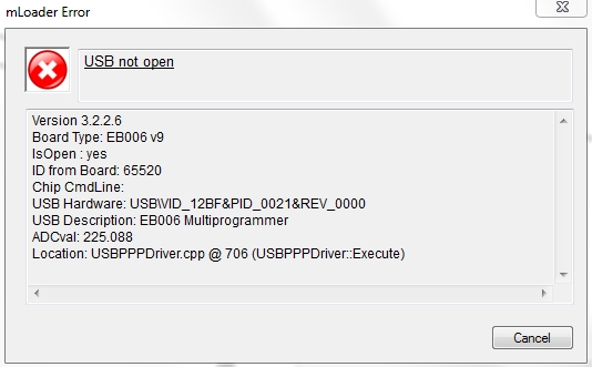

I load the HEX file then try Autodetect: it says unable to communicate with target. I press Send, says I need to select the chip but the chip I'm using is not available in the <select chip> drop down list. I edited the 8bConfigData.csv (copied the 18F2680 and renamed as 18F26K80). Now I can select the PIC, press Send, it says "the chip could not be detected. Click OK to use specified, D10 flashes a few times and the progress bar shows some activity. Did it program the chip? There is a warning "Flash memory not verified - may be due to code protect). Press Execute does nothing (MCLR high, OSC not running, shouldn't it?). Press Erase, says wait then complete, did it erase? Lastly press Update Bootloader brings up a window displaying version 6:1:9:7. OK this window and an "USB not open" error pops up then "Close programming mode failed" message. I am attaching 2 JPGs to clarify my action sequence.
mLoader - USB not open error.jpg (56.23 KiB) Viewed 5035 times

Hello Ras,
Unfortunately that chip is not supported by the EB006v9 board. You can see which chips are supported on the datasheet of the EB006v9.
http://www.flowcode.co.uk/old_site/resources/file ... 6-30-9.pdf
Sadly, adding it in at this point would not really be feasible.
