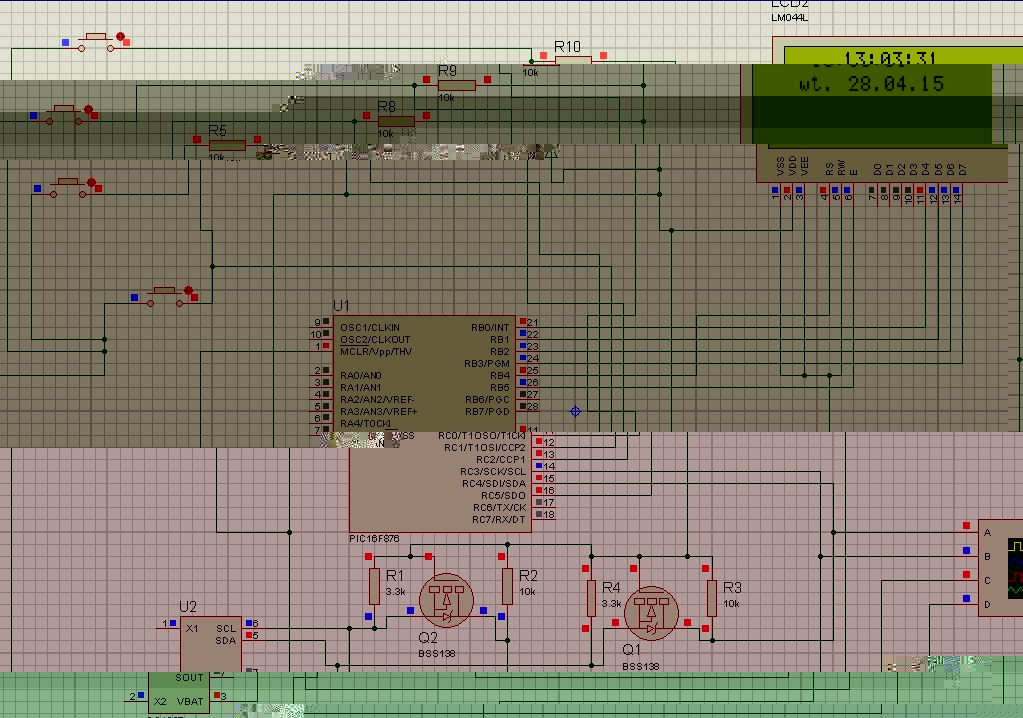

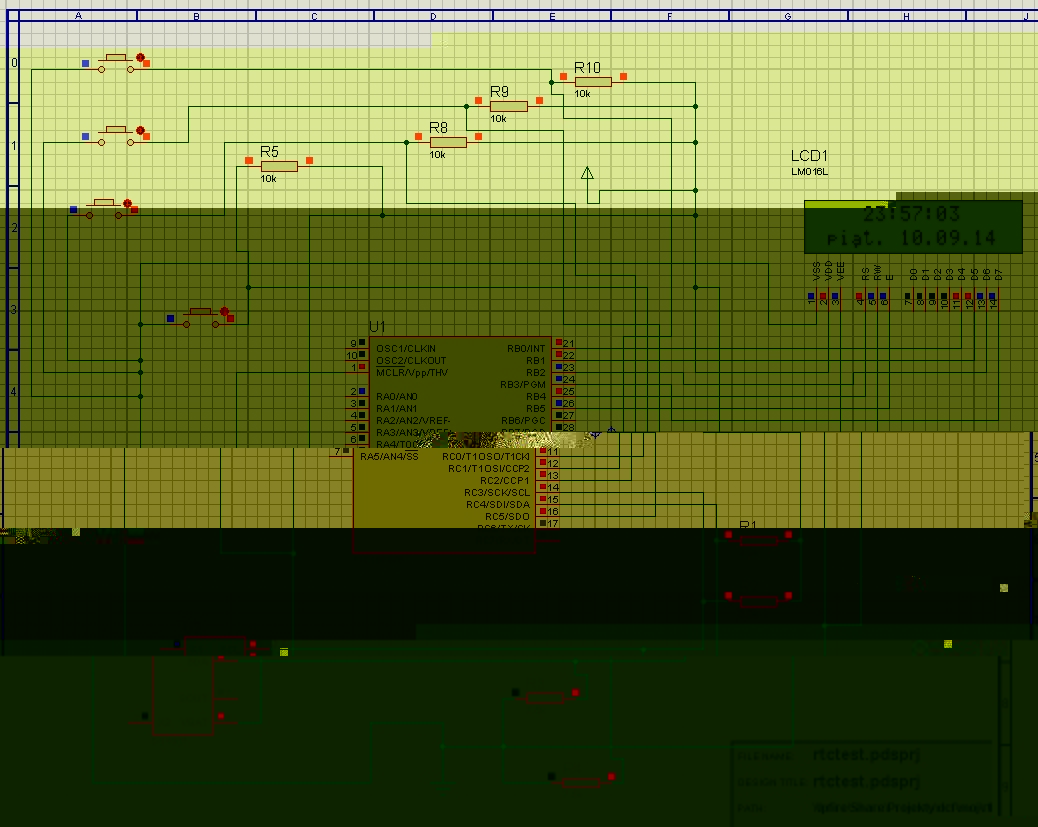

Hello!
After a very long break, back to the topic. I have a few questions to colleagues. I was able to run the system but in a strange configuration. In the drawings. The system is working properly when the resistors R3 and R4 are connected (Figure 1) When is disconnected (Fig. 2), the system operates incorrectly. What can cause this condition. I would add that the same real system behaves.
Witam
Po bardzo długiej przerwie, wracam do tematu. Mam kilka pytań do Kolegów. Udało mi się uruchomić układ ale w dziwnej konfiguracji. Na rysunkach. Układ pracuje poprawnie gdy rezystory R3 i R4 są podłączone (rys.1) Gdy zostaną odłaczone (rys. 2) układ pracuje błędnie. Jaka może być przyczyna tego stanu. Dodam że tak samo zachowuje się realny układ.
Witam
- Figure 2
- (473.76 KiB) Downloaded 14068 times
- Figure 1
- (480.23 KiB) Downloaded 14068 times

Hi siwo278,
No,
Voltage converters are not required.
I have not got them on my hardware (pic 16F device), and RTC is working.
The issue I can see with your circuit is the resistors connected to SDA and SCL must be pull-up i.e go to +5V and not GND
No,
Re: DS1307 RTC
Yes I understand that pull up resistors are needed. This is required by the standard I2C. But in my particular case, and specific systems where only those resistors there is no communication between the DS1307 and the PIC16F876. When installing additional resistors to GND appeared communication (to my surprise - after all, it differs from the standard I2C). The program loaded into the PIC work (there was communication and properly interpret the data from the RTC). So why do not these resistors that are connected to GND does not have this communication. Program leaned on solutions on this board, so they are checked. So I do not know the PIC processor to write directly in the "C" in MATLAB. And only such a solution (with voltage conversion) made to measure their knowledge found. I know that this solution is a paradox because wsumie nothing should contribute immediately but in the simulation works. I checked it in the real system operates like but freezes the action processor. I went back to the additional resistor connected to GND. Owiele work better. I do not know what to do, and the code will not flovcode change anything because I do not even know what. Ultimately, the processor is clocked 6,1440Mhz, for the purpose of checking the progress of programming are treated 4MHz. By default I2C not change anything. What now?
