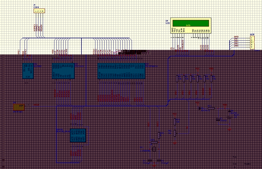

Hello
Can I ask for help in properly setting PIC18F46K22. In my program uses two USART ports with a maximum speed of 1200, LCD, RTC72421, a few buttons. FLOWCODE simulation program operates in accordance with my expectations. Real array or even a simulation in Proteus detached from the what shows FLOWCODE. I understand that it is not realistic simulation system, but they give a picture of the device. By reading various online forums and their experience with PIC systems I know that a large roles is as the same processor configuration, unless the PIC16 family of processors somehow give advice, that's for PIC18 lost in the maze of settings. In the Appendices is my program and a potential way to connect.

Here are some configuration settings you could try changing.
Primary Clock Enable Bit - Enabled
Single Supply ICSP Enable Bit - Disabled
Extended Instruction Set Enable Bit - Disabled
Background Debug - Disabled
Also the MCLR pin is routed to a Reset part on your schematic. Does this tie the MCLR pin to VCC via a resistor?

Hello
MCRL pin is connected to the DS1813. Thank you for the suggestion, changed in the program. The cause of failures in the simulator was a fragment of program code which, for the real system should work well (but more on that to convince assemble as a whole) and it does not work simulations. As for the passage of the time of transmission by the RS.
