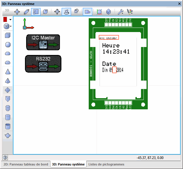

Simulation the line:
.CHR_tmp = Mid $ (mois, (.tmp * 3), 3)
.tmp * 3 = 24
Constant

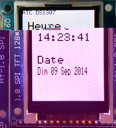

mois = "JanFevMarAvrMaiJunJuiAouSepOctNovDec"
The simulation gives ""
reality gives "Sep"
Thank you

Many thanks for letting us know. Yes it does look like a bug. I think if you changed the constant to a string variable then it would work in simulation and download. However you have probably got a better solution using a constant so I have added this to the bugs list for our engineer to try and find a solution.
