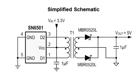

I need to control a MOSFET. But the MOSFET must be separated powered. There are commercial isolated DC-DC convertors available, like the e.g. SN6501 see figure. But why using this IC when a microchip is available?
with Vin=5V
with Vin=5V
Switching the gate of the MOSFET by means of a transformer, like in the figure, seems a bad idea to me. That will not be fast enough. But the microchip can countinously produce a 50% PWM which can be transformed to the 5V needed for the gate. The switching of the gate can be done by means of an optocoupler, powered by this 5V (at the collector of the optocoupler). The current will be extremely low.
My question is: should it be possible to use the PWM as source for the transformer?

HI jan,
In short yes you can not sure why you want to do this when there are plenty of pwm ic around and also dc dc convertor "bricks" , that save on the programming and other circuits that are required that do it all in a single module or an 8 pin ic (mostly)
I have had a go making my own dc dc convertor a couple of times and found it to be a minefield. I would recommend a dc dc brick type from traco power they are very good devices and the hard work is done for you just drop it in and away you go
attached is some guidance notes on switch mode psu's that may be of some use
if you look on ON SEMICONDUCTOR web site they have lots of reference designs for switch mode psu's
steve
