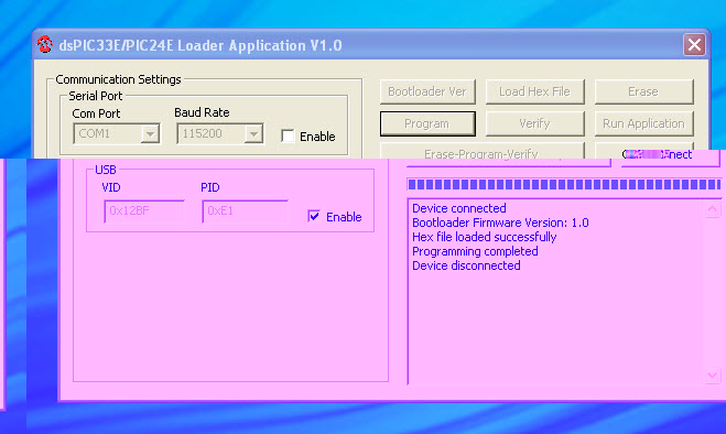

To test this the dsPIC ECIO bootloader will work with this tool from Microchip: http://ww1.microchip.com/downloads/en/D ... loader.zip
Simply enter the USB VID 0x12BF and PID 0xE1 to connect to the device. If this works ok then it points to an mLoader issue.

I reprogrammed the ECIO40P16 with the boot loader Hex file and then used the PC_loader from MCHP and it working fine
Led flashes after +/-5sec it stopps to flash
I can program with pc loader my application software and it is running fine ,
Thanks for helping out here :D
