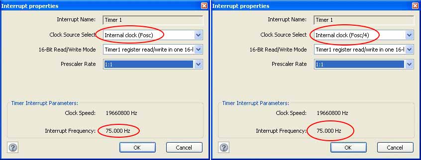

Hello!
In the Timer1/3/5 properties window the interrupt frequency not updated by the choosen option (fosc or fosc/4), see picture. Tested with PIC18F46K22, PIC18F46K80. Maybe all others, where this option is available, affected.
The hex file is not generated with PIC18F46K80 / 26K80 if the flowchart contains Timer1 and/or Timer3 interrupt. The compiler message:
Launching the compiler...
C:\Program Files\Flowcode 6\compilers\pic\boostc\boostc_18F.exe  -v -t PIC18F46K80 "Flowcode1.c"
Launching BoostC...
Completed BoostC compilation, return = 1
C:\Program Files\Flowcode 6\compilers\pic\boostc\boostc_18F.exe reported error code 1
Why dont the compiler give more detailed error? When i made a mistake anywhere in the flowchart (including unconnected component pin), always got error 1, nothing else. Hard to find the problem...
