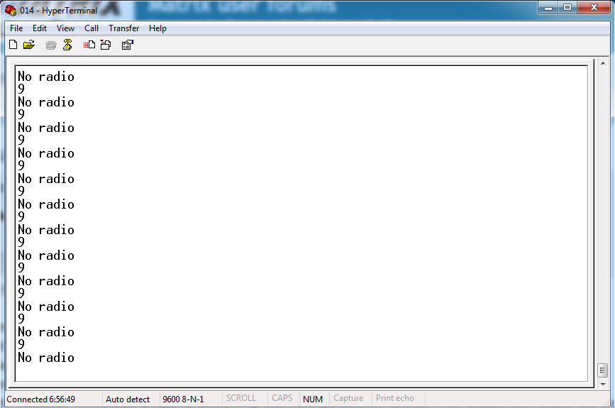

Both modules initialized properly according you configuration(checked with scope).But could not communicating each other.
Hyper Terminal showing result like this , What is your opinion on this result?
The chart I've posted is used for the Flowcode component and it works for me.
There are many reasons why this can occur.
First of all: power problems.
Look on the internet about the many issues with power supplies for this module.
