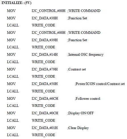

Hi Guys.
I have an I2C display model Winstar WO2002A-TFH-AT # with the ST7036 IC control.
I tried everything but I get to initialize properly.
The datasheet is according initialization (Initialize 5V.JPG). But as I write this with the component display I2C ?? ..
Thank you
Thank you

Re: How initializing a display i2c winstar ??
If you look at page 16 of the datasheet then this lists the format of the I2C commands. Use the I2C Master component to output the I2C data.

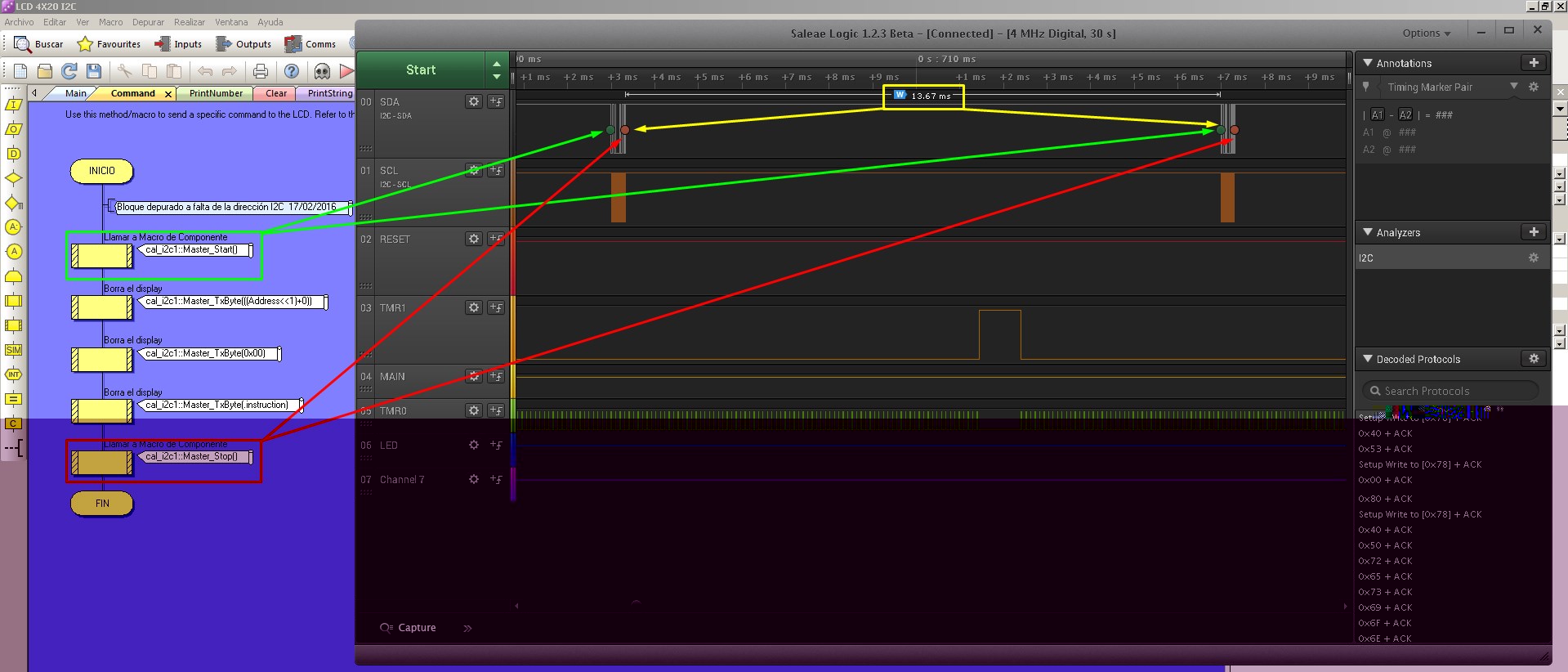

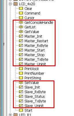

Good morning.
I have already 4x20 I2C display component exports. But I have three questions.
1- When you export the component blocks shown me that I do not need are CalcI2C component. As you can take from appearing in the exported component ??.
2. When sending several commands 13,67ms there is a time between the end of one and the beginning of the next command, you can make that shorter time ??
The message we have to send is too long and need to put less time between commands.
3- How can I concatenate two strings ?? , for example:
S SCR_00 String [20] ""
S SCR_01 String [20] "Value 1"
S SCR_02 String [20] "Value 2"
SCR_00 = SCR_01 + SCR_02 need to concatenate Strings SCR_01 and SCR_02
How can I do it??
Thank you
I do not know about the delays, are they in your code?
You can concatenate two strings like this ...
It looks like you might have "inherited" the sub-component macros, like so ...
Un-tick the box to not inherit them.
Hope that helps
Leigh
