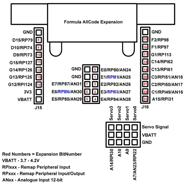

I got my buggy today and now wonder where I can find out what is connected to what on the buggy. And when will the coarse online be available? Thanks, Bill

Hello Bill,
We should be publishing the course on the website later today.
Here are the chip connections.

Some errors on the direction of repositionable pins
Bruno

Benj wrote:Hello Bill,
Re: formula allcode
Hi Bruno,
Many thanks for letting us know.
Re: formula allcode
Hi Bruno,
Many thanks for letting us know. I have now made these changes to the image and curriculum, I'll get it changed on the website ASAP.
Thanks again.
Thanks again.
