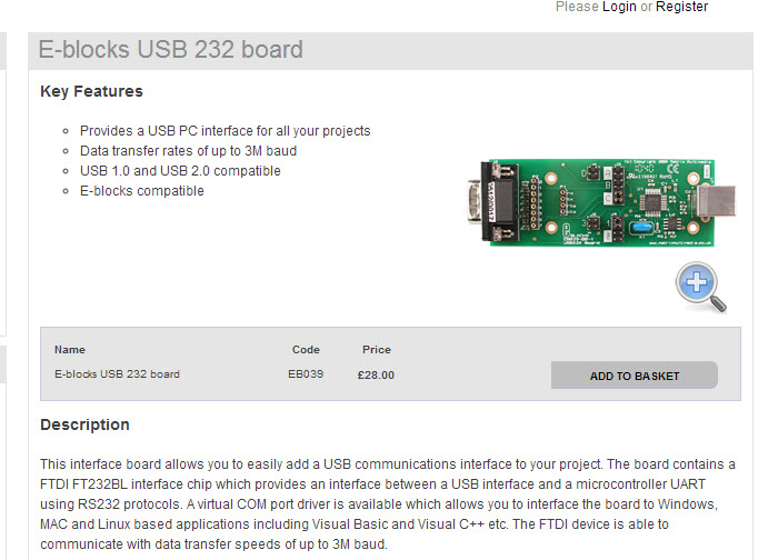

As a cheap workaround you can use a USB to serial Chip and communicate with it from your UART on the AVR and you have the same functionality
http://www.flowcode.co.uk/product.php?Pr ... PHPSESSID=
