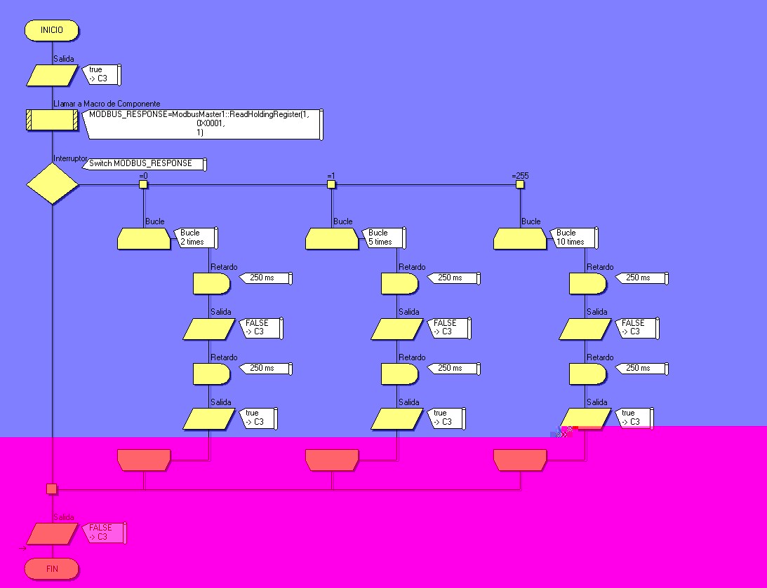

Good morning guys again.
I implemented the modbus component in my project.
I have a Modbus slave emulator for testing. the emulator receives the query and responds but the teacher always gets time out.
Someone has made some example to understand my mistake?
Thank you

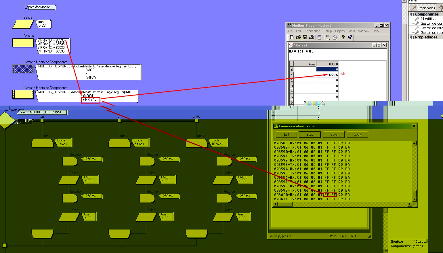

Hi guys.
Attached the program modbus master file.
In the Main routine, I Initialize including Modbus Master.
I found out a curious thing, when sending only a register (PresetSingleRegister) responds sending me the same thing.
When I'm sending four registers (PresetMultipleRegisters) responds with an error "03 = Illegal Data Value. A value Contained in the query data field is not an
allowable value for server (or slave). This
Indicates a fault in the structure of the remainder
of a complex request, the implied Such As That
length is incorrect. It does NOT mean Specifically
That a data item in a storage Submitted for register
has a value outside the expectation of the
application program, since the MODBUS protocol
is unaware of the significance of any individual
value of any special register ".
Why does this happen?? are the same records with the same structure.

Changed your flowchart to modbus ascii and captured message:
First sending the "ARRAY[0]" and then the whole array... (Putty output on the right-->) Compared to MBpoll the Flowcode seems to send it differently? Heres mbpoll sending only one: Here im sending using mbpoll software the value 65535 over my "loopback" com adapters, to see what ASCII comes out. Settings are Modbus ASCII over serial, ID 1, function 16 - write multiple registers, start address 1, quantity 4.
And here we send multiple: Any ideas/traces to the problem here Matrix team?
I tried deconstructing the messages the MB master component sends...
It might be that the FC16 is just missing the number of data bytes to follow, and thats why the slave is not answering anything (as the message is "seemingly" missing CRC/or is too short)?
helpful page to understand modbus bit easier
:01 10 0001 0004 PP PPPP PPPP PPPP PPP2
01 SLAVEID
10 PRESET MULTIREGISTER (FC16)
0001 START ADDRESS
0004 REGISTERS TO WRITE
PP NUMBER OF DATABYTES TO FOLLOW
PPPP VALUE FOR 0X0001
PPPP VALUE FOR 0X0002
PPPP VALUE FOR 0X0003
PPP2 VALUE FOR 0X0004
CRC MISSING
:01 06 0001 PPPP PK
01 SLAVEID
06 PRESET SINGLE REGISTER (FC6)
0001 DATA ADDRESS OF THE REGISTER (+40001 OFFSET), WILL WRITE REGISTER 40002
PPPP THE VALUE TO WRITE
PK CRC VALUEhelpful page to understand modbus bit easier

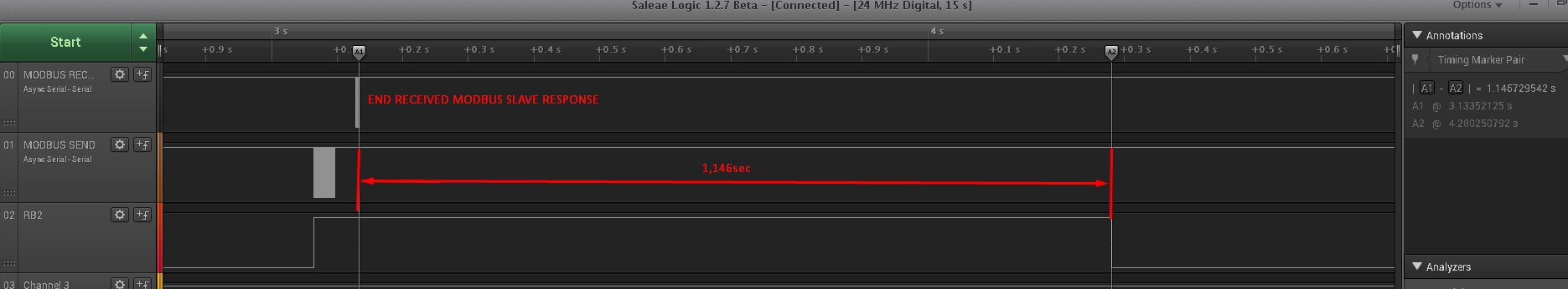

hi Benj.
The new component is much faster than the previous but still have a very large pause 1,14sec after receiving the response from the slave.
You can add a variable to adjust the timeout or time out after receiving the answer ??
My big problem is that the micro does two UART communications and also checks and evaluates the data, if a pause or a delay occurs, the micro does not work on your other tasks and are very important.
Deputy capture the graph of time.
Thanks again for your time, I feel very proud to have flowcode, there are a great team in your work.
thanks, thanks and a thousand thanks

Any chance I can see your program?
The component should return immediately after the reply so I am wondering if you are maybe calling the GetResponse macro again after the PresetMultipleRegisters command. I've looked in the program above and you don't seem to be doing this.
Of course it could be something wrong in my time out logic so I will go back through and see if I can spot anything further for you.
