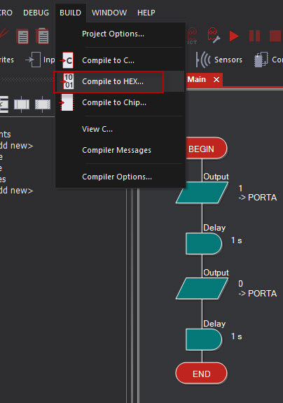

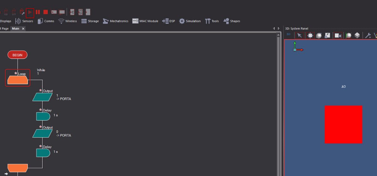

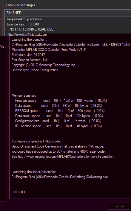

Hi Attached is your project modified that it will constantly flash the led at pin A0
(1)You can run the file ib Simulation mode by pressing the arrow key then you project is executed in simulation
(2) once you are happy with your project and simulation you can generate a hex file by going to build >> compile to hex which you will see the compiler window opening and generating the hex file ,with this hex file you need to program into your chip with programmer
(3) When you have a MATRIX or PiCkit3 programmer you can set it up as the programmer in flowcode and then you use the option compile to chip where the hex file will be generated and flashed into the chip if it is connected
all these option are working fime with your example project however to have a useful program you need to have a continues loop as I did in your project compare main with yours

Thank you.
Yes, I forgot to add a loop.
For me, it did not generate hex file, but generated c file, when I clicked on compile to hex. It is giving me message: "You do not have a valid licence to perform this action". (See attachment)
I did not yet activated the paid licence, it is still free version.
I have PICKit 2 clone. I wanted to try if it works with FlowCode, and if it works at all.

Hi Slobodan,
The free version will only allow you to compile with a limited number of target devices.
I don't know all of them, but I do know 16F88 and 16F1937 are two of them.
12F series are not, that's why it won't compile
