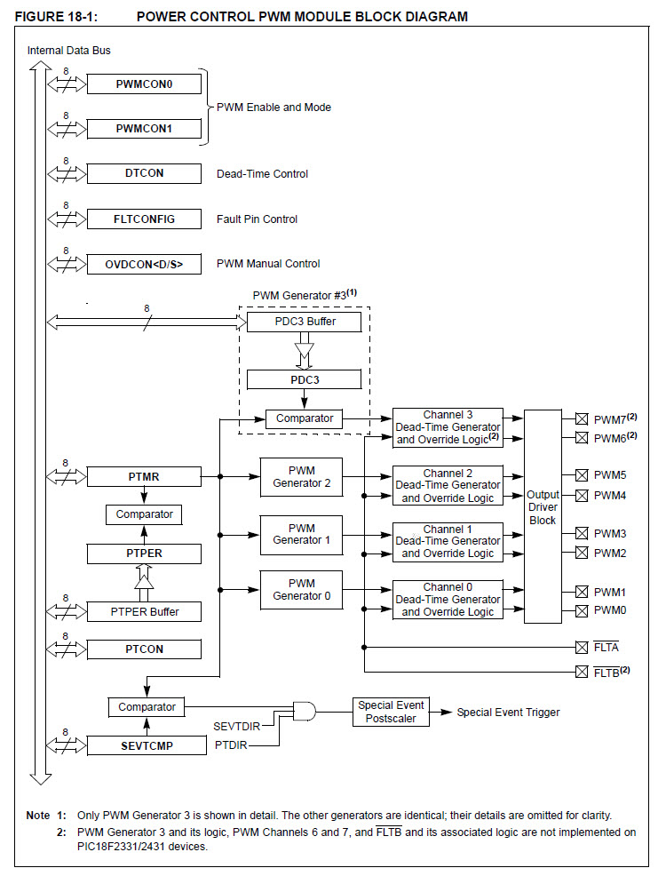

Hi Bill,
I would advise you to look at the Power switch module of the 18F2331 as this module is designed to run Power switching which allows you to control a motor in very fancy ways what you are doing with the normal PWM blocks is fine
and by useing them you have no other option to do as you are doing ,
I would move my Control of the motor to the Power Switch Module if I were in you position
Here is an example FC 6 Code to run a DC motor with the Power Switch Module on an EB022 hope this helps you :D
