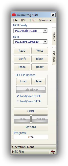

Is it possible to compile to HEX with FlowCode7
and then send the hex with Mikroe mikroProg Suite to the Mikroe Fusion Experimental card with dsPIC33EP512MU810 ?
Matrix has unfortunately no experimental board for dsPIC33EP512MU810.
An experimental board solution must be found.
(Any other idea ? )
Would FlowKit work on the USB to Mikroe Fusion ?
PicKit would be a solution but searching the web indicates that PicKit 3 has issues
with firmware and doesn't integrate without problems into the Flowcode workflow.
That's makes it interesting to look at Mikroe mikroProg Suite as an alternative,
I have not tested any of thew - I would very much appreciate comments first

Yes this is possible.Is it possible to compile to HEX with FlowCode7
