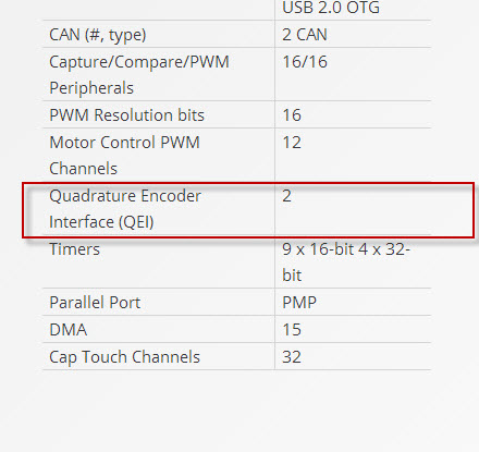

The dsPIC33EPMU810 will work perfectly as it has 2 QEI interfaces however If you intend to make a product out of your development I will then use the MU810 for development and look for a MC device which is cheaper for production
becasue it is not a USB device with that said the code you developed on a MU810 will translate 1 to 1 to a MC device

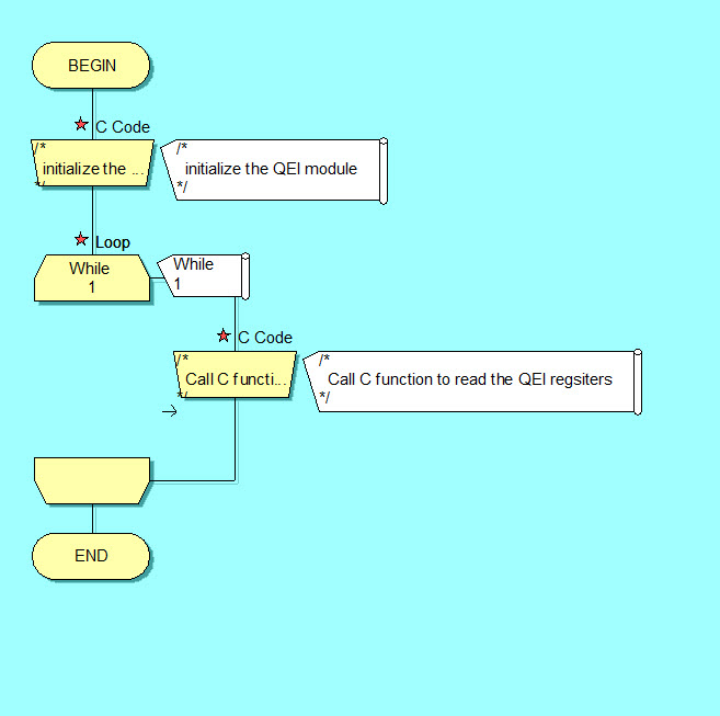

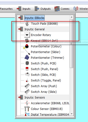

In my opinion there are now two ways you can go about this pulse counting
(1) You can use the standard FC Encoder component located in Inputs menu
place it on one of the panels and then edit the pins for the Encoder inputs under the properties menu
this is the easy way as FC does all the coding for you however this is a SW encoder function
(2) This method you use the hardware QEI module of the chip which count and resets the counter as you have configured it including the pins for this you need either to make your own QEI component
or use a 2 x C function call one to initialize the module before the while loop and one during your code execution to read you the QEI counters all of this needs a bit of C coding from your side but it is also the most cost effective regarding cycles used to execute the Rotary encoder function ,you have to read the QEI interface chapter in the datasheet to understand how to configure and use the module

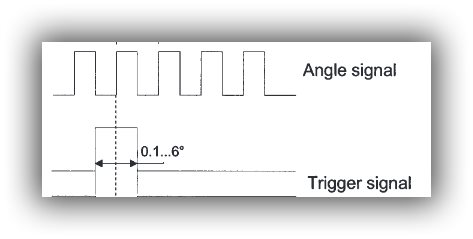

The basic problem seems quite simple. A trigger signal resets the counter and the Angle Signal counts up.
That's all- 2 pins needed

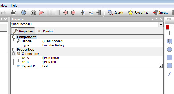

dsPIC33EP512MU810 has two QEI modules
and when you pick Input - Encoder Rotary and place it on 3D canvas
it suggests $PORTB.0 and $PORTB.1
So far so good, and everything seems defined.
Now I would expect to insert this into the block schematics without additional C-code
How ??

Can anyone give me an idea how to make it without adding C-code ?

Re: Counter to track engine crankshaft angle
Thanks for valuable info.
The two phase delayed count pulses should obviously be connected to B0 and B1
To the right in the image at the red arrow, you are dealing with hardware connections
totally outside the program flow (I guess).
But to the right; QuadEncoder1: ReadCounter etc... should and must be in the software loop
The problems as I see it is
1. ResetCounter is controlled by software.
It should be dedicated to a pin and hardware connected to the counter. Is that possible in FC7 ?
( I am working with dpPIC33EP512MU810 and it has 2 QEI )
I guess it is important for speed reasons to keep count-up*2 and reset outside of program flow
Best regards
Bengt
