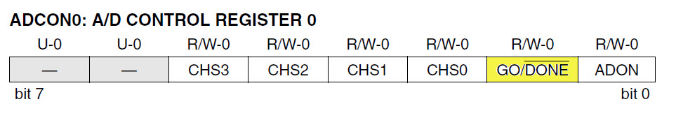

You can get a manual for the compiler at the Microchip web page ,
If you are using a PIC18 then the ADCON0 bit one is the GO/DONE bit
In the XC compiler you would use ADCON0bits.DONE however I saw a post from Martin which mentioned something about to add the over score you need to include $ sign but not sure where and how
I am also still learning FC interaction with XC8 however I am well aware of how the XC8 compiler functions in a Normal Editor
so I do not want to mislead you in this case with the DONE bit which has an over score on a second thought you probably could use ADCON0bits.GO
Ben or Martin will help us out here

You can find the names that the compiler accepts if you search in the device header file for the register name,
e.g. search for ADCON0 in ..Flowcode7\compilers\pic\include\pic16f1937.h
There you will see that this register bit is named GO_nDONE, or GO, or nDONE
So you could use:
Alternatively, if you know the bit number, and not the name, you could use the test_bit macro instead:
Hope that helps,
Leigh
ps. Just came across this generic solution too, from medelec35 http://www.flowcode.co.uk/mmforums/viewt ... 26&t=17804
