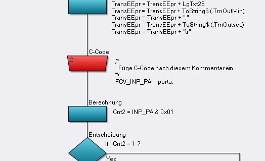

Solved: Please Help, error while compiling my project
Problem solved!
This time I was able to locate and fix (the) error.
Initially, the error described above. After I turned off all the icons that performed calculations, came this error:
0: (499) undefined symbol:
_reset(FourChannelTimer_26K22_Light_V7.obj)
It is to despair! What please is an "undefined symbol" where it all icons are used only from Flowcode?
After a long search the solution: C-Code
After I had the icon deleted, re-inserted and filled with the same command, everything was suddenly without error.
Detail: when I had FC6 functions such Nettime and Email via GSM remove because no program memory was present (99% in use without Nettime and email!).
With FC7 with these functions to get to about 70%!
That comforts me across the hassles of troubleshooting. I'm excited!
