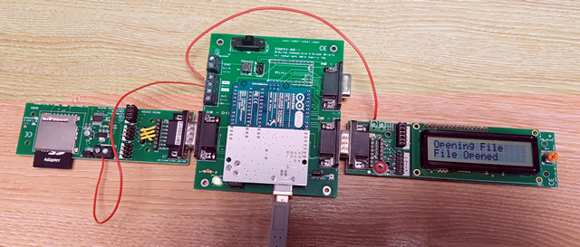

Hi Benj, I tried one of the WIKI examples (FAT_Read_File) with my hardware but it does not work, looks like there is no communication with the SD card. The return value is 0xFF but it retrieves this value even with MISO and MOSI lines disconnected. An example from the Arduino website is able to communicate and works with my hardware, so I discard the possibility of not functional parts. I did create a "test.txt" file in notepad and save it to SD card, the WIKI example supposed to display the contents of the file but it's not even initializing. I'm using a class 4 SanDisk SDHC and I tried three more regular SD cards from different brands with the same result, I also checked my voltages to the card pins and are all 3.3 v. I hope you can solve this issue soon. Thanks a lot for your support. Best regards! :mrgreen:

I simply changed the initial prescaler from 64 to 128 in your program and it started working for my various SD test cards. Not sure why but 250KHz at /64 seems to still be too fast for the initialise.

HI, Benj. Thanks for your quick reply on the FAT issue. I was very excited when I red your post that I want it to try it immediately, unfortunately it did not work for me. Now it just return the byte 237 "0xED - Sector Bytes Error" on all my cards. I retrieve the return code from the forum that you provide to one of the members.

It works!! I tried changing just the initial pre-scale to 128 as discussed but when I tried it did not work. This time I was having communications with the SD card and it was sending back a byte "0xED - Sector Bytes Error". Then after posting the previous message I decide to try a different pre-scale setting for the high speed data transfer to 64 and... it does communicate and display the data correctly!! why the difference between my results and yours?? You just needed to change one pre-scale setting an I had to change two, why?? maybe the hardware used?? It was just a setting problem the whole time but how to figure this out when the software actually tells you that the initialize clock should be below 400kHz which it was correctly set it to 250KHz. It does not matter, I'm happy with this component being functional, now I can finished my project. Thanks a lot for your help. I'm posting the program with Arduino Uno. Thanks again! :mrgreen: I also have to say that the program on my first post its working as needed.
