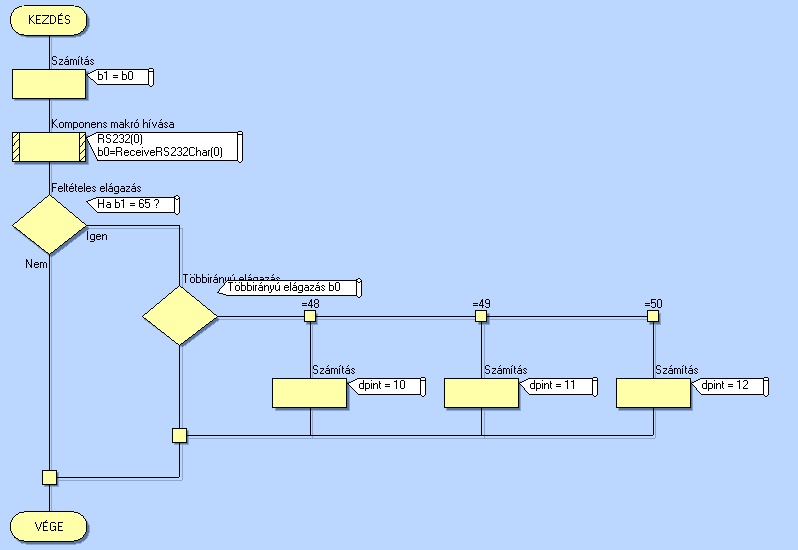

The display send "A0", "A1" or "A2" if you touch an object. Receiving it by UART interrupt:
UART Interrupt.jpg (59.32 KiB) Viewed 26019 times
As you see, not necessary to send lots of characters by the display, if you using only some touchable object, the data can be only one byte long.

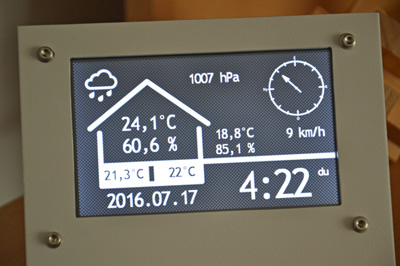

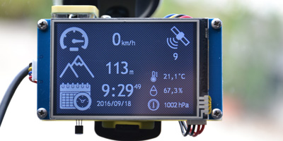

This two projects created in Flowcode, using only UART commands and UART (RS232) interrupt:
Nextion HMI 1.jpg (41.28 KiB) Viewed 26019 times
Nextion HMI 2.jpg (32.85 KiB) Viewed 26019 times
AndrewC
Flowcode v5 User
Posts: 28
Joined: Wed Oct 02, 2013 12:16 pm
Has thanked: 7 times
Been thanked: 7 times
Re: Nextion displays.
Post by AndrewC »
Thanks Bachman. :D That's a great help, just what I was looking for.
Mine has just arrived so I've now got a starting point and can now play. :)
