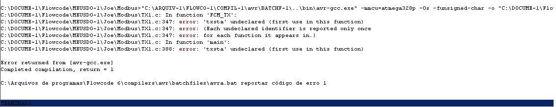

Dear
I'm trying to run the suggestion of Sean, 485tx1 in my version 6.1.3.2, and I'm not getting, someone help me? File and the error codes are in the Annex.
Sean wrote:I have attached a small code segment that illustrates the 75176 direction control. It assumes that RC5 is being used as the direction control pin, and that a single character 'X' is being sent.
Dear
- compiler_error.JPG (52.5 KiB) Viewed 23943 times
