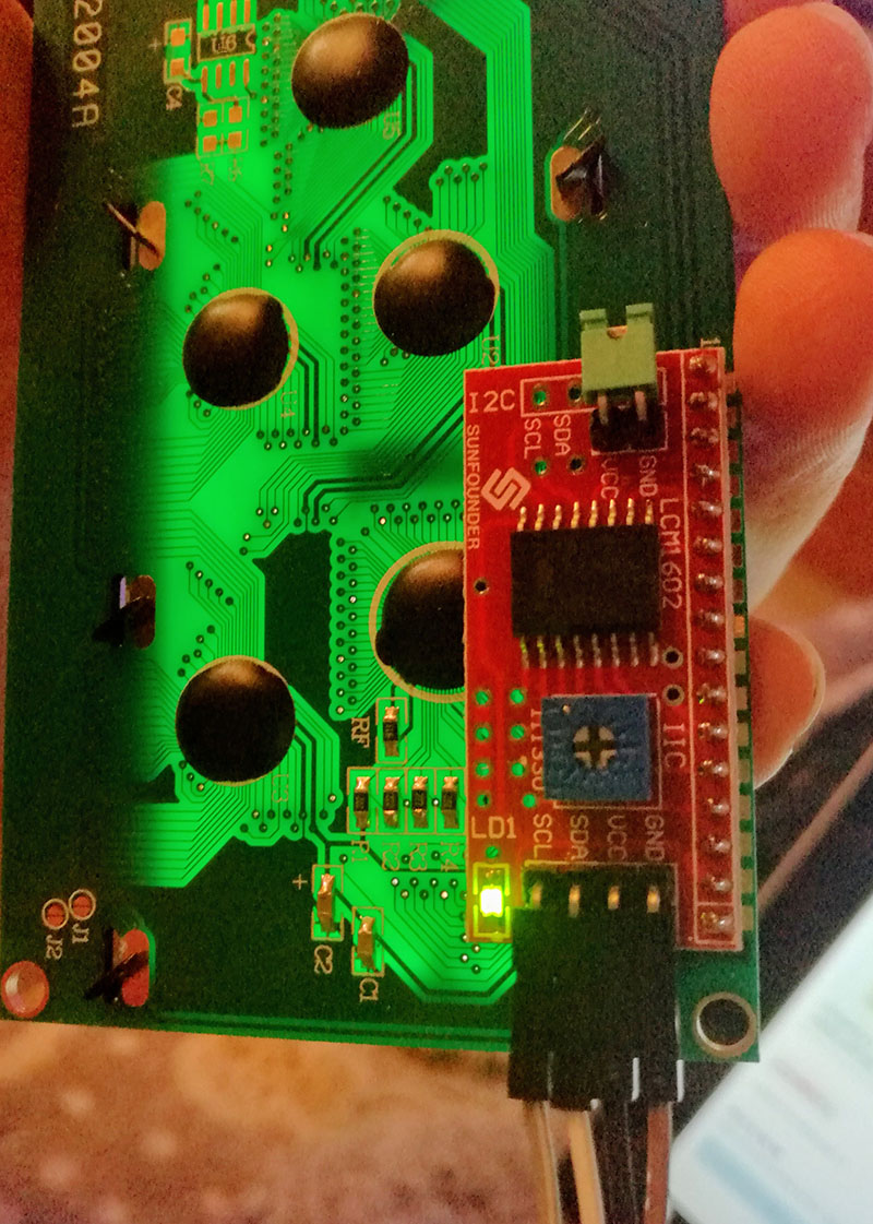

Re: Connect Grove LCD RGB to Base Shield on a Arduino
I have buy a alternative arduino kit with a right lcd i2c, today i can try it, when i retry tpvuse a i2c lcd, not work
kersing wrote:Please resize pictures to normal (800x600 max) dimensions before posting. These pictures are far to large.
- test.fcfx
- (5.84 KiB) Downloaded 347 times
- IMG_20161221_160844.jpg (144.89 KiB) Viewed 19495 times
- (257.24 KiB) Downloaded 2177 times
Did you try this?maybe try an LCD address of 62 rather than 124 and see if that makes any difference.
Where did you find 124, i have in i2c config 32, i'll try 64 and 124 and not workBenj wrote:Did you try this?maybe try an LCD address of 62 rather than 124 and see if that makes any difference.
