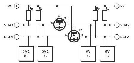

Philips started with I2C. In 1998 in the Elektor magazine [1] an application note of Philips has been published to convert 3.3V to 5V and visa versa, see figure.
I2C 3.3 to 5V.jpg (14.96 KiB) Viewed 4847 times
Four MOSFETs were mentioned, of which only 2 are available now: BSS83P and BSSN20BK.No values for Rp are given.
