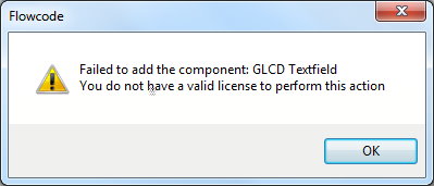

The new component TextField.fcpx does not work for me, that’s why I had to modify the FlowCode given example.
I receive the message below:
GLCD Textfiled license.jpg (19.43 KiB) Viewed 17225 times
Why? Because TextField.fcpx component was made for Flowcode 7 and I use Flowcode 6?

Re: Slow Graphical LCDs
The textfield component is a new development and relies on existing v7 gLCD modifications so is not currently compatible with Flowcode 6 and unfortunately would be a fairly significant amount of work to make it so.
